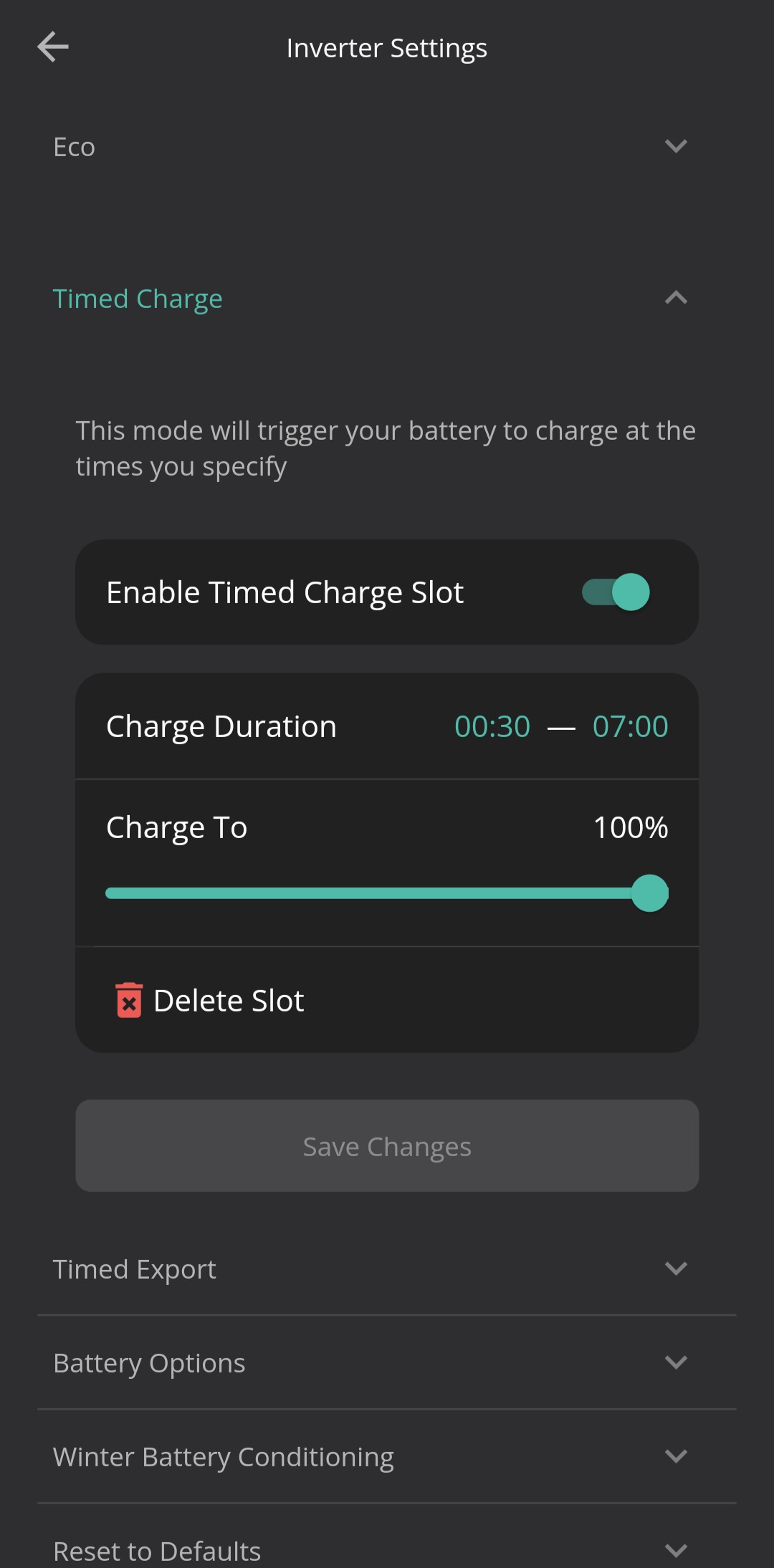

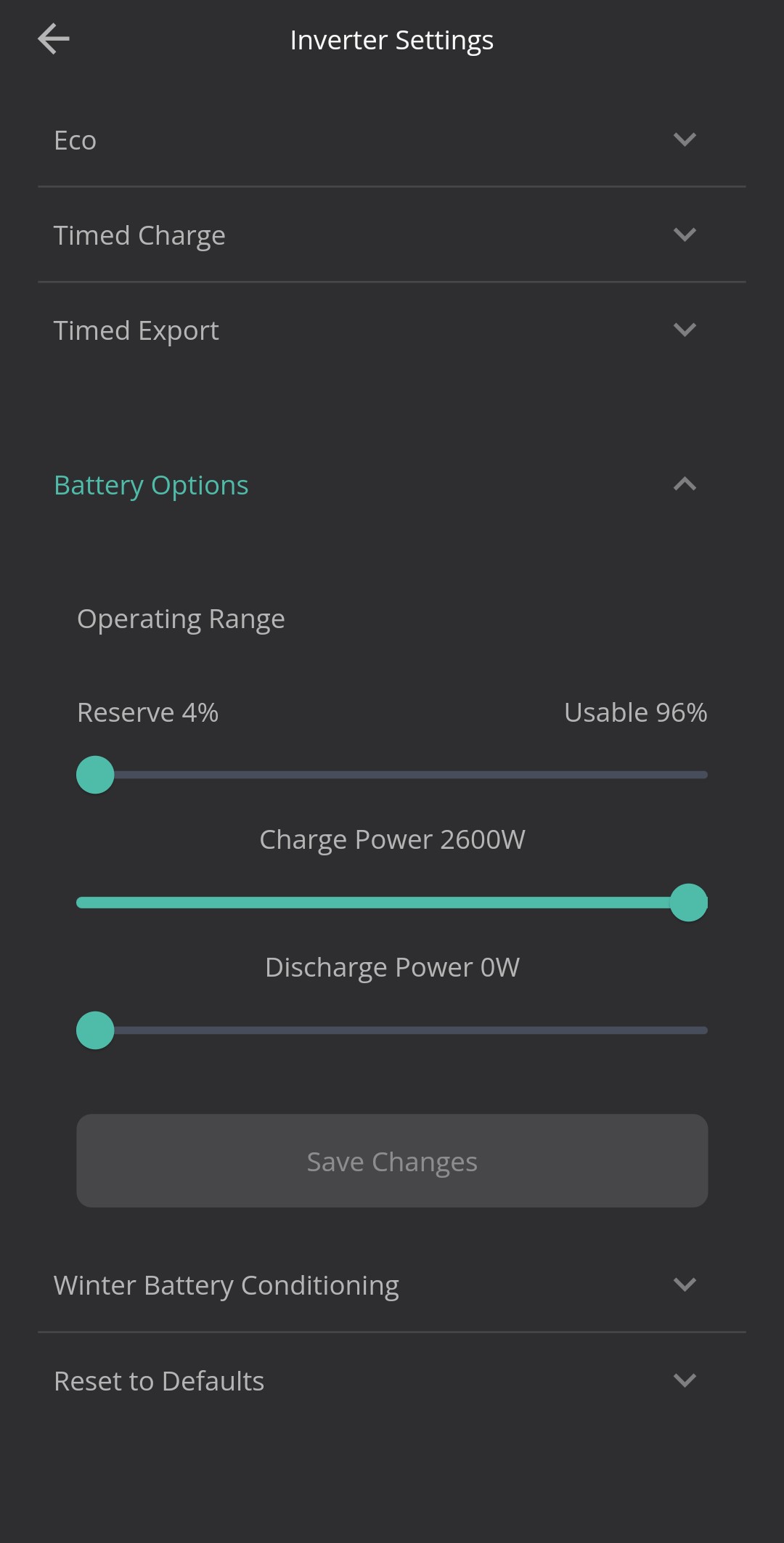

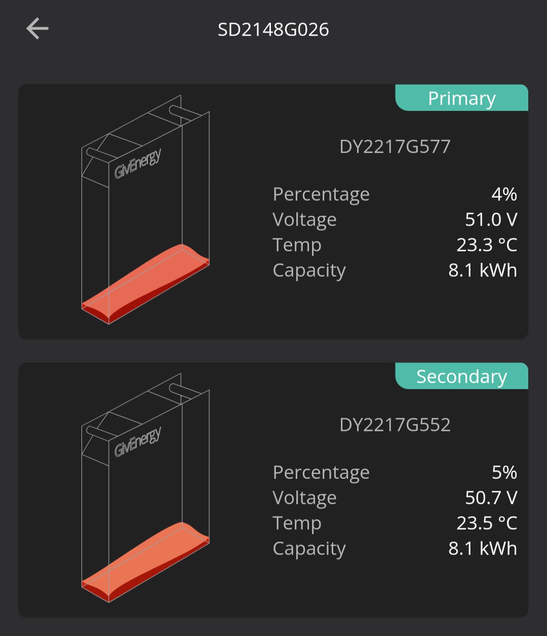

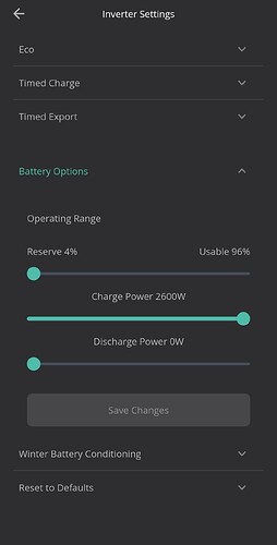

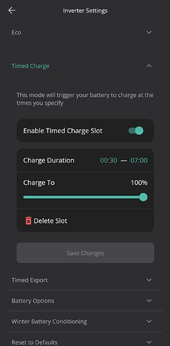

This is occurring more and more, now. Inverter at idle when scheduled to charge. Anyone else having this issue or knows how to fix it? Last night’s battery states and charge settings pictured. Recently installed a new battery firmware, but that has made no difference.
You mention that you have recently done a firmware update. Usually after the update everything is set back to defaults. Even though it looks like you have a charge slot set this may not be what the inverter sees. Try changing the start and end times and save them. Then change them back again. Also turn off the timed charge slot and then turn it on again. I always use the cloud portal to check after an update by refreshing the reading displayed. Usually my time slots have been reset to 00:00. Hope this helps.
