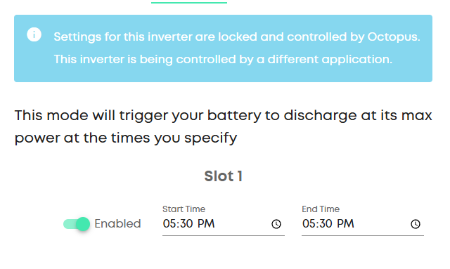

This screenshot is from the cloud account stating it is locked by Octopus. It stated on their website that any settings saved prior to adding to Octopus could cause issues. I assume that that is what has happened here so just need the lock to be lifted. It has been Octopus’ end just need it from GivEnergy’s end.
Gosh Tom, whereabouts in the GivEnergy cloud portal do you see this message? The system I am looking at is on the IOG tariff but nowhere does it say so. Hitherto I understood that once you go through the selection of the Octopus smart tariff and put in something called an API key absolute control passes to Octopus from their end, to the extent that anything you try and adjust at the GivEnergy end gets overwritten - even without telling you that,
This is under the My Inverter > Settings. All the options state the same.

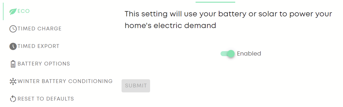

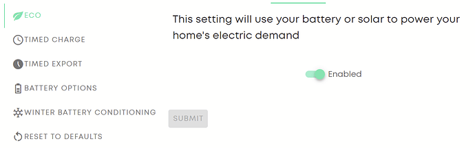

This is what my Inverter Settings screen looks like, as if I have selected Eco mode and as if that is in force. And yet the electricity supply for the property is definitely on the smart Intelligent Octopus Go tariff, and visibly behaves like it eg when an EV is connected up to charge. Remote control commands appear as if by magic.

When you go onto OIF you create an API key for Octopus to control your inverter and as @Tom96 has shown, Octopus lock your ability to change the inverter settings.
There does seem to be problems with people leaving Octopus whereby the remote control lock still remains in place.
