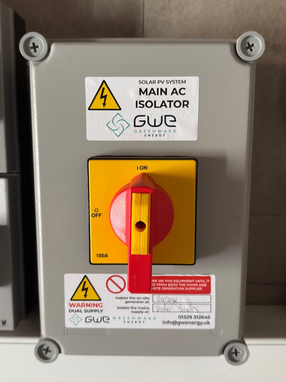

I just turn off the yellow/red switch to test GW EPS.

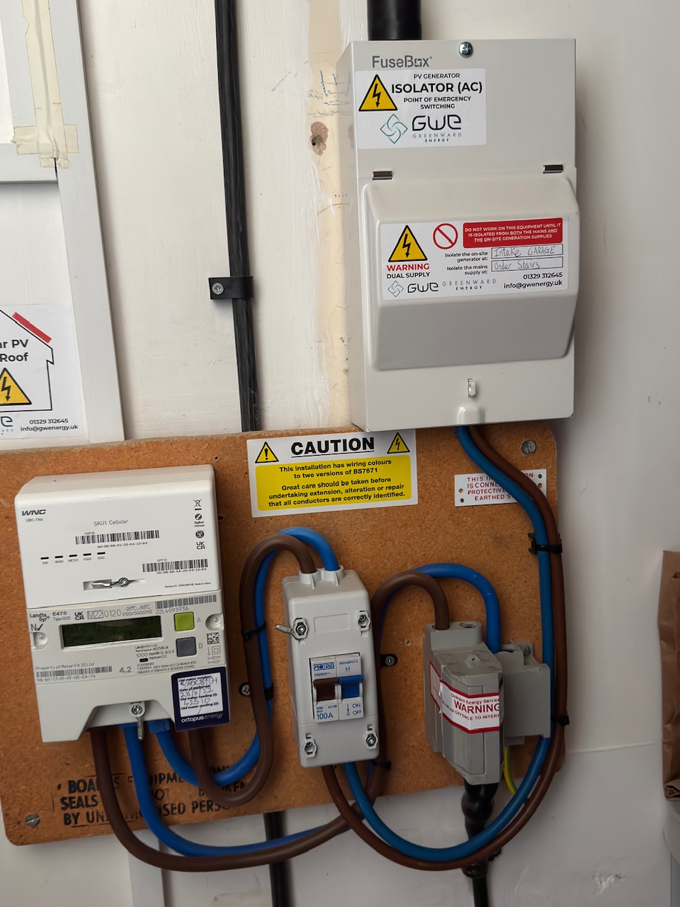

My circuit goes:-
  1. Cable into the house to the main fuse.
  2. Cable from fuse to Meter
  3. Meter to new switch
  4. Cable from switch to new CU to isolate the circuit to GW
  5. Can to isolating switch (in garage next to GW)
  6. Cable from GW to house CU.
Hmm, interesting, you’ve got 2 isolators in series there. Odd arrangement! Not sure why any leccy would do that.
The big red & yellow one is just for the pv system though, it won’t affect power to your house from the grid.
But all I have is a fuse on the supply side of the meter, which is as it was when the house was built. (& I suspect, as most do with any house more than a few years old).
I don’t have a trip switch between the meter and gateway, just the main fuse. I’m fairly certain that as Chris mentioned that flipping the grid switch in the gateway should replicate a grid failure.

I have tried with the isolator between my meter and gateway and via the Gateway grid switch and have experienced identical EPS behavior via both methods. So should be a valid test.

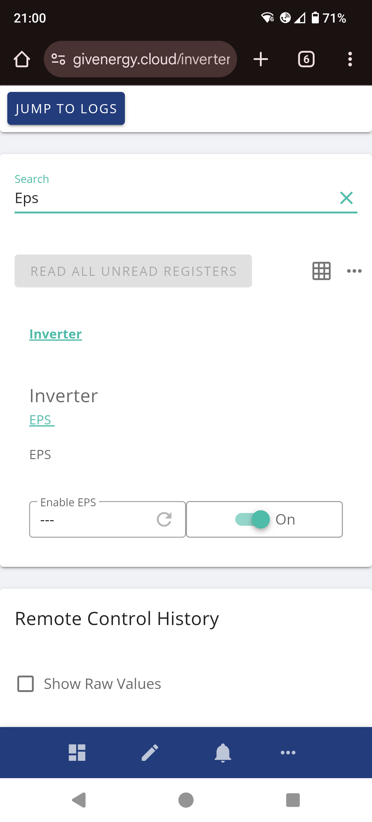

In your settings the first thing I would check is EPs enabled. It’s in my AIO meter settings
P.s I also read on other forum posts that there is some hidden meter values regarding a delay for eps to kick in. Not sure if installer can see it in their portal or if it needs givenergy support to enable it.
Hope it helps.
