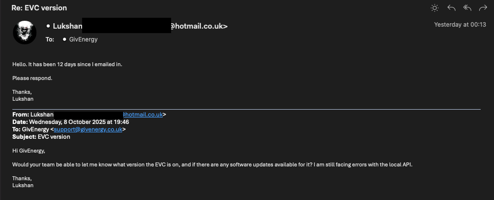

Maybe I was just lucky but, using the Support live chat option rather than email, I got an instant response and my EVC firmware was updated in real time.
I recommend giving live chat a shot if you can. Good luck!

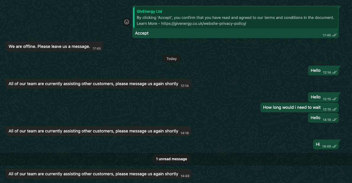

This has been a great experience lol.
Yikes! Looks like I was extremely lucky!
