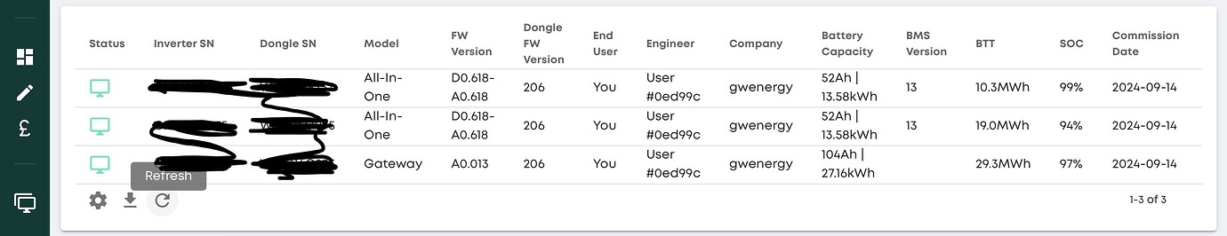

This is my FW.

Interesting - I’m on FW D0.613-A0.613 so 5 versions behind you, dongle FW I’m on 902 (yes 902 - no idea why the huge difference!) and my gateway is on A0.008 so again 5 versions behind you.
I had a look at the installer page but can’t see a version history. Anyone know what has changed?
Try this ?
Magic - no idea why I couldn’t find them!
So yes it looks like I should update then - lots of bug fixes etc in the interim. I’ll do that tonight when battery is discharged.
