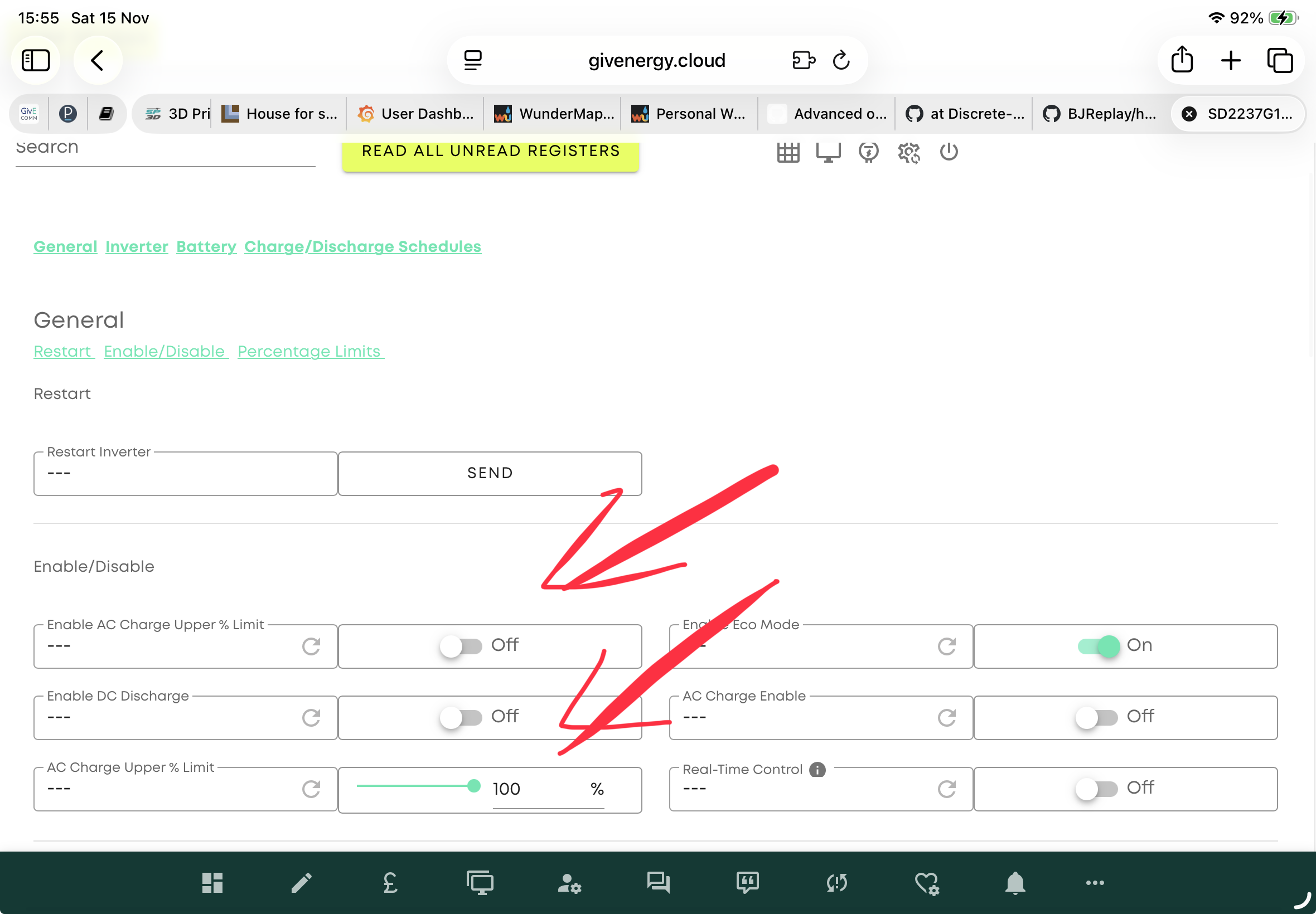

Look in the givenergy portal for your inverter under the configuration settings (cogwheel) tab:
Thanks Geoffrey, That’s exactly what I can see but it’s made no difference. In addition, during peak times, the house is pulling from the grid, as much as 700w and less than that from the battery, and there’s nothing I can do about it. I have set the discharge time from 1600 but makes no difference. I’m convinced there’s an issue with the battery. Perhaps a recalibration but that’s beyond my capabilities.
The recalibration option is on the same page of the portal, you can initiate it yourself. Be aware it will fully drain then refill the battery so set the time when its sensible to do so for your import tariff
