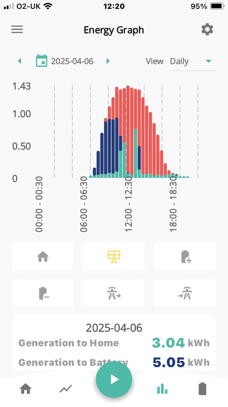

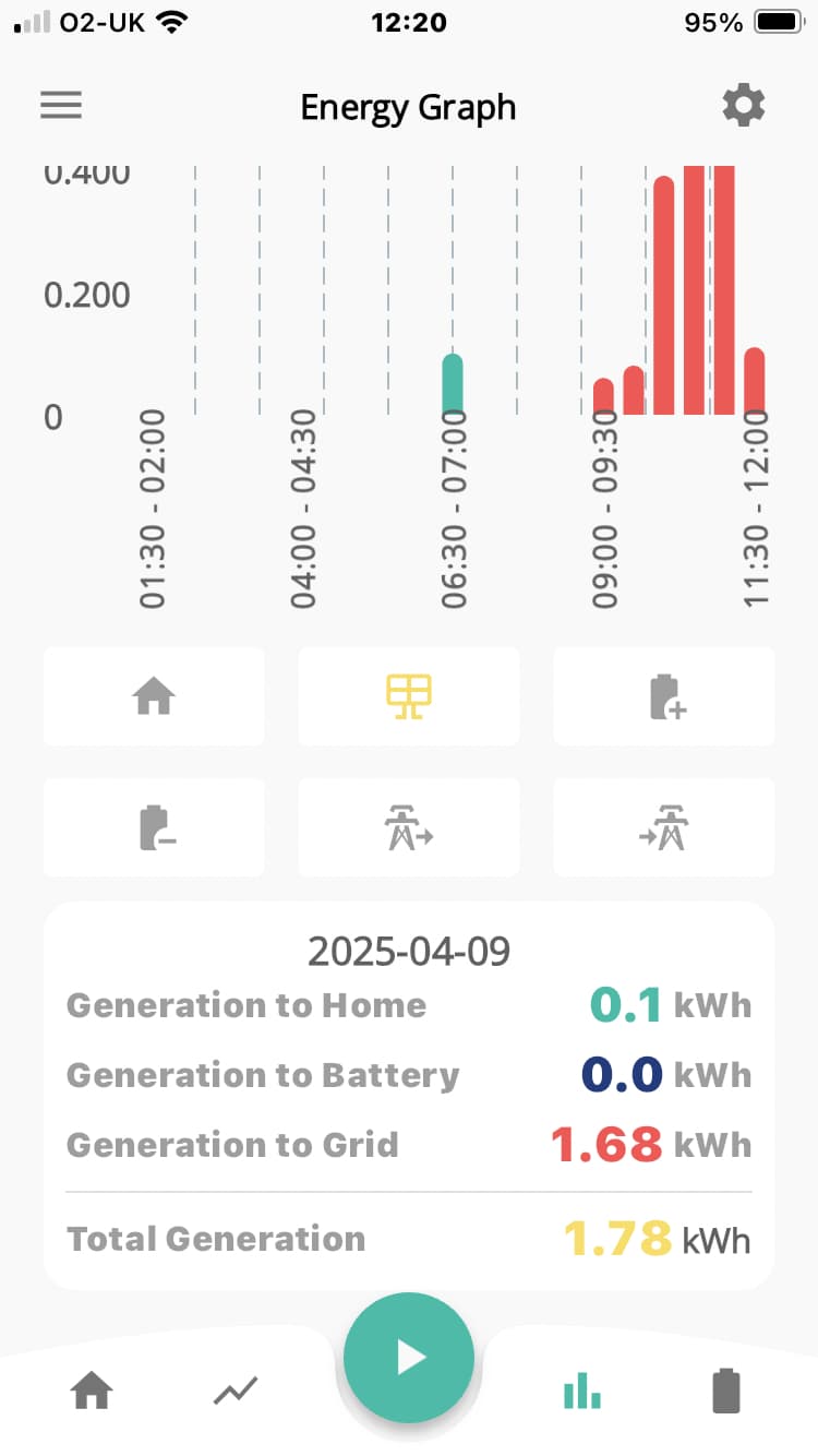

What’s happening here? Sun blasting since early. Normally like 6th, but today starts producing at 09:00 . Why?
Something seems off in my app too - it’s now saying that for the last week or so I’ve been importing several kWh from Grid to Battery during the day … which is nonsense. I force charge my battery briefly at 02:00, then it charges from our Generation during the day.
it could just be a problem with the app graphs
if you look in the givenergy portal at the meters view for your AIO you can see the raw data as snapshot every 5 minutes
if that shows solar generation starting when you expect it to, then it’s just an app error
The data in the app is broken for many people. Big topic about it on the non-beta forum.
My Enphase IQ 7+ microinverters stopped working on 06/04/2025 which meant I wasn’t generating any solar until yesterday when my installer came round to kick them into life. If you’ve got the same microinverters then this may be your problem as well.
