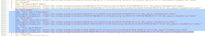

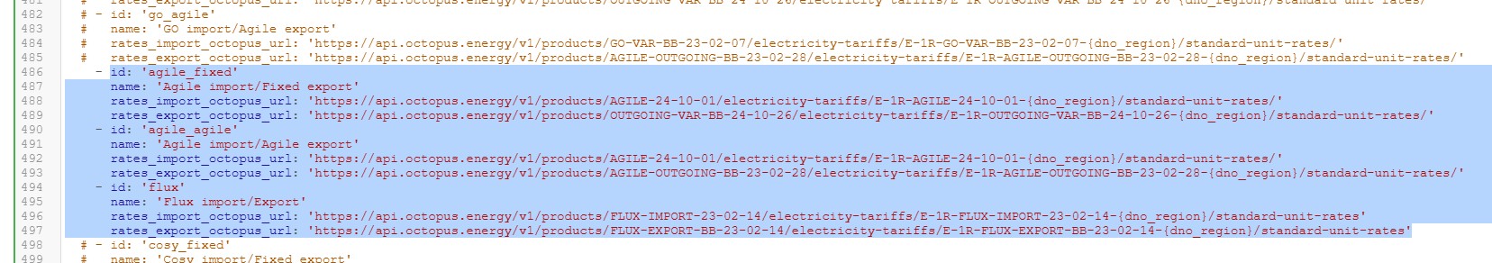

The -BB codes were withdrawn some time ago, the Flux export in September 2025, and that’s what’s causing the compare not to work. I’m surprised your agile codes are working still.

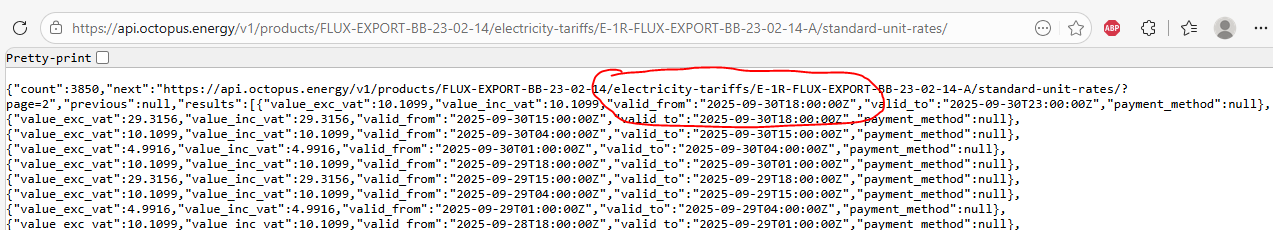

If I look at the code you are using:
Notice the valid from and to dates

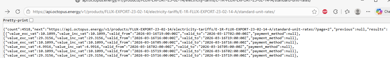

And the correct code to use
