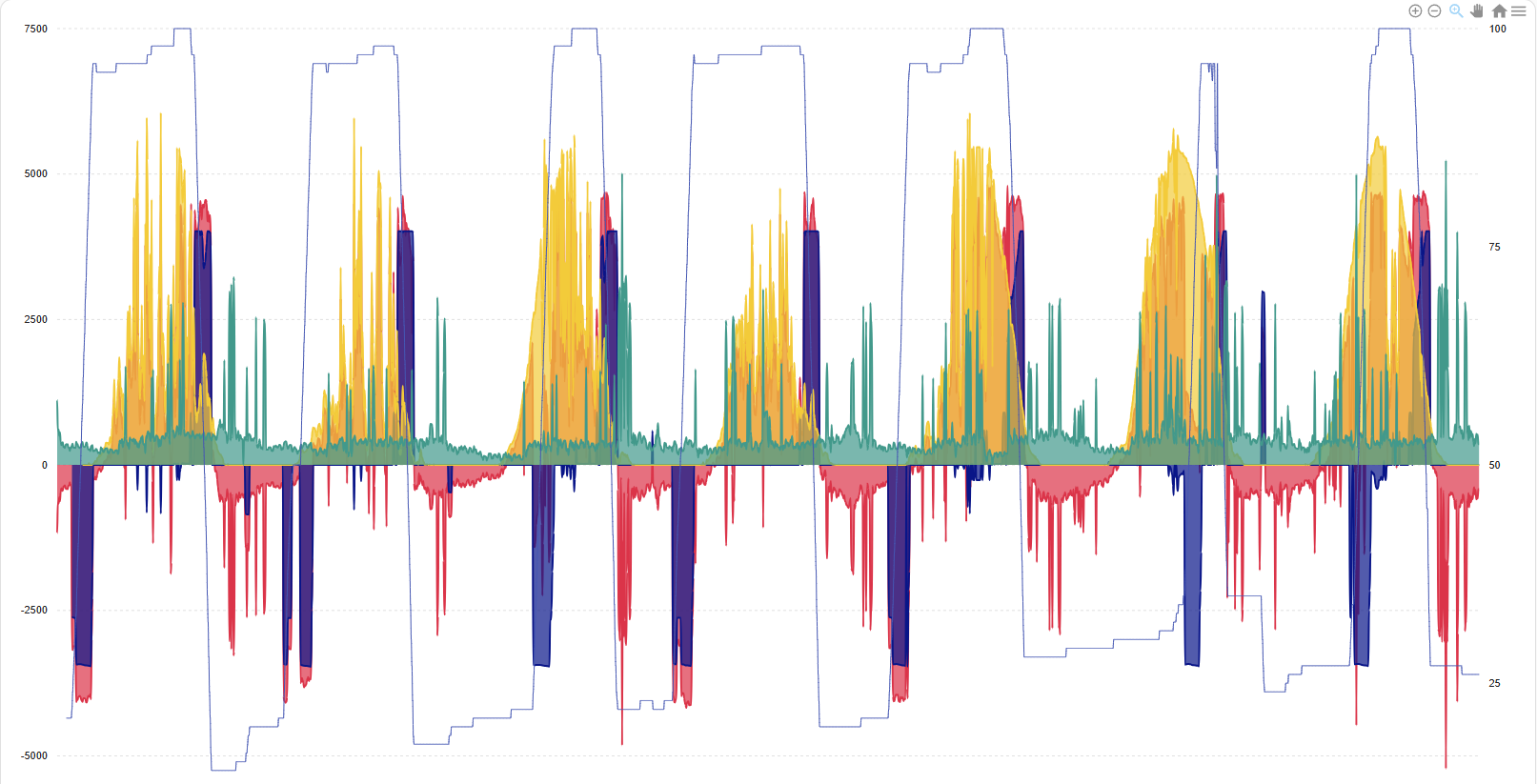

This is my last 7 days on IOF,
Over night charge if it’s going to be less sunny, late morning charge if sunny forecast.
A bit of solar ‘clipping’ charge during the day taking the battery the last 3-5% to full..
5pm-7pm discharge to ~20%
My COSY/Export vs IOF break point is 1.05* gen to use.
