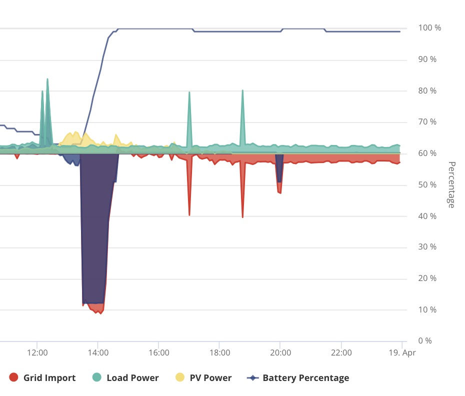

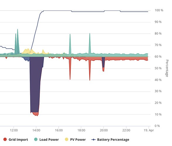

For several weeks while the weather has been great I have had no timed charge settings on my AIO + Gateway because the PV was bringing the battery up to 100% by lunchtime every day and we were then exporting to the grid. However even though there are zero settings timed charging is occurring at random times and for random periods. WHY?

In âMy Invertorâ on the portal there are no âtimed chargeâ set and on the app on my iPhone it shows â0/10 Timed Charge Slots Usedâ. In âSmart Tariffâ no âautomationsâ are selected. In âPower Flowâ one can clearly see âgrid inputsâ. For several weeks these have been keeping the battery at 100% from about 18:00 to midnight (usually the battery has been at 100% at sundown but we have background demand of 400w) but bizarrely yesterday it also kicked in grid input between 13:25 and 14:40 taking the battery from 63% to 100%. I will try and attach images.

it definitely does look like an inverter grid charge from the power flow
