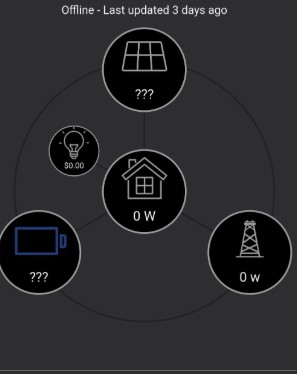

Hi All and Thanks in advance
I recently subscribed for the premium subscription since I was not able to monitor my system.
Suddenly 1 day the internet was not able to connect and I tried everything but nothing worked and eventually I had to reset the internet in the Inverter by resetting the dongle.
The dongle is connected with the internet since I can now connect to the dongle and browse easily.
The issue -
My App is not showing anything basically is offline just like the online dashboard
This is after I have paid the subscription as well.
I have emailed the premium support but no response in 3 days.
Can someone please let me know what i need to do to get the system live.
I have restarted the system
I have changed the internet 2 times (by resetting and by simply logging into the 10.10.100.254 router)
The internet is specifically for this inverter coming from a TP LINK Extender which only puts forward a 2.4Ghz connection.
Thanks in Advance.
