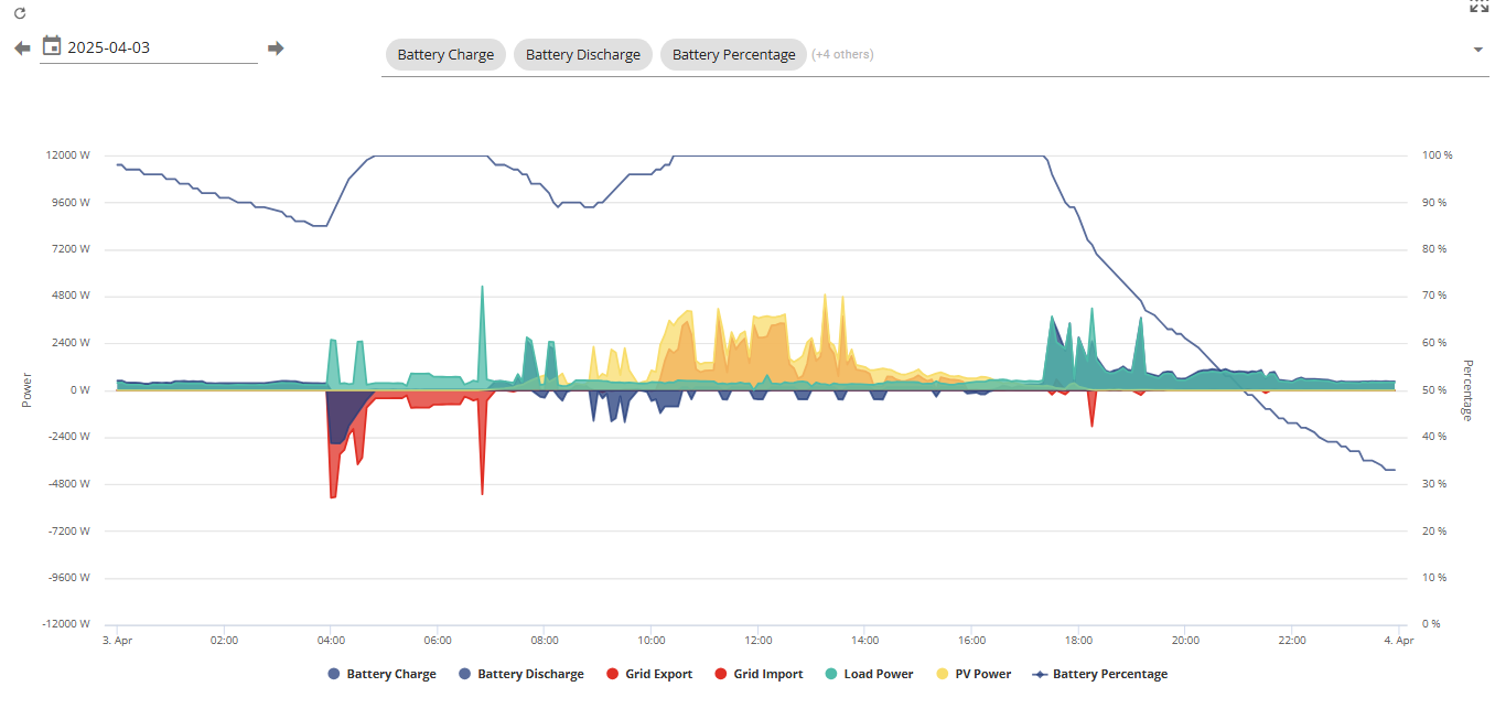

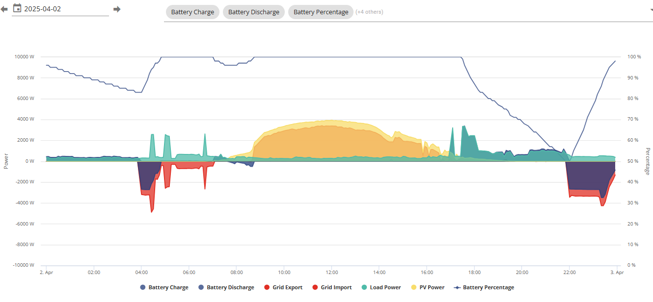

typical day and sunny [had a few recently] charging on the 4am to 7am and 10pm to midnight slots

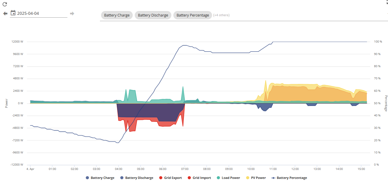

yesterday just the 4am grid charge and the rest PV and battery over night.
to this morning/today… a longer charge
