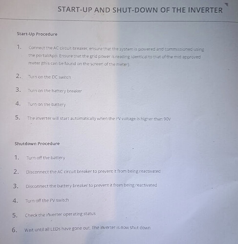

yes you should shutdown your inverter first. There are shutdown instructions in the givenergy installation guide (google for it). You should normally have AC, DC (solar) and battery isolators, and there’s a sequence of events to follow to shut everything down in the right order and prevent any risk of damage

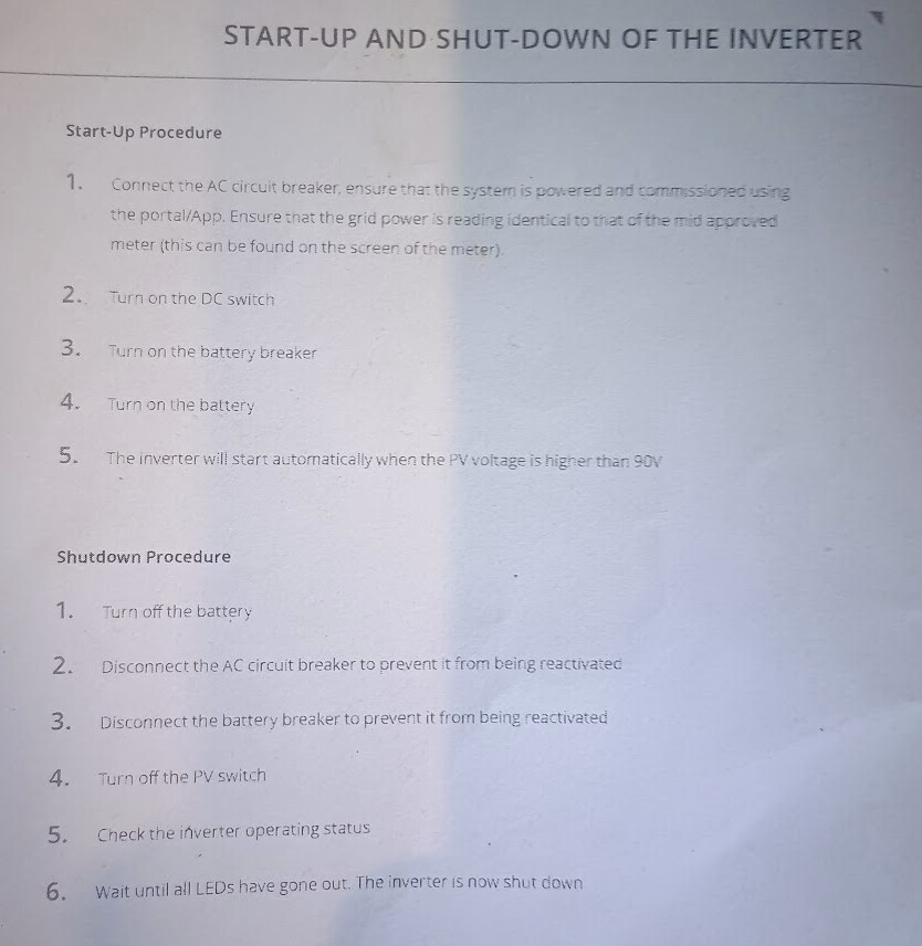

Maybe you can advise on my setup for shutdown of the inverter. I have a PV isolator switch (rotary) which is red/yellow (not black). I have a battery isolator (rocker) switch. And an on/off rotary switch on the bottom of the inverter. But there’s no DC isolator. Is this a problem?
This I keep near mine (hybrid…)
The ‘PV isolator switch’ sounds very much like an AC isolator switch to cut the AC power to/from your inverter and batteries.
There should be somewhere a black DC isolator between your inverter and your panels.
If there isn’t then that sounds like an installation problem as you do need it because you don’t want to power off the inverter when it is under load, converting DC power to AC.
All is not entirely lost though, you can still shut your inverter down to remove the dongle, but do it ONLY at night when there’s no solar generation.
And maybe you need to get your installer back to fit the DC isolator. I thought it was an electrical wiring requirement
