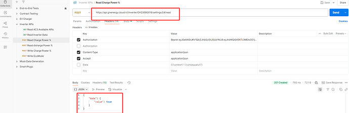

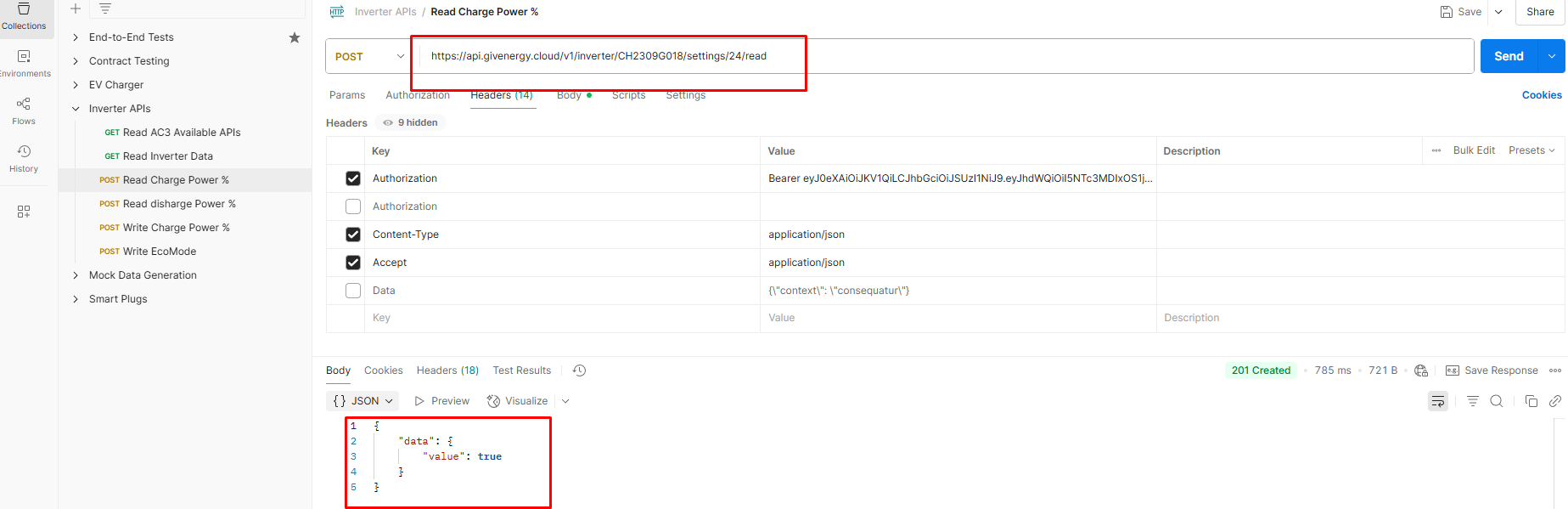

and as you see here your exact request on my own inverter reads just fine
This is using Postman
