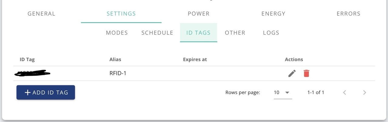

You add them in the app or cloud. Click the add button, type in the grid number give it a name and expiration date (I have not added a date).
I then plug in the car, wait a min, then touch the rfid on the EVC over the rfid symbol.
If you car does not charge I would check your charging settings, as it maybe restricting it during the day or from the grid etc. try plug and go setting from the grid, to test it works, then change the settings back to what you would like.
Here is a screen shot, I have only added one tag. (But you get 2 with the EVC)
Thanks @daveb01 Is the “grid number” you enter the number on the tag of the form NO.1300xxxx? Or something else?
Yes you enter the number on the tag and give it an Alias. I would add both and test both.
Ok thanks - that’s what I thought I had done but will try again. Thanks for your help.
@daveb01 sorry one more question just to be completely clear I’m trying the right thing. Do you include the NO. in the grid number or just the 8 digits?
Just the 8 digits
Thanks @daveb01 I don’t know what I’d been doing wrong but I have now followed your instructions and managed to get them to work. I didn’t have a notification pop up on my version of the app but I just went to manage Id tags and added the tags while the car was plugged in using just the 8 numerical digits. Thanks so much for your help and for taking the time to provide such clear instructions.
Your very welcome, we are here to help :+1::smiling_face_with_sunglasses:
