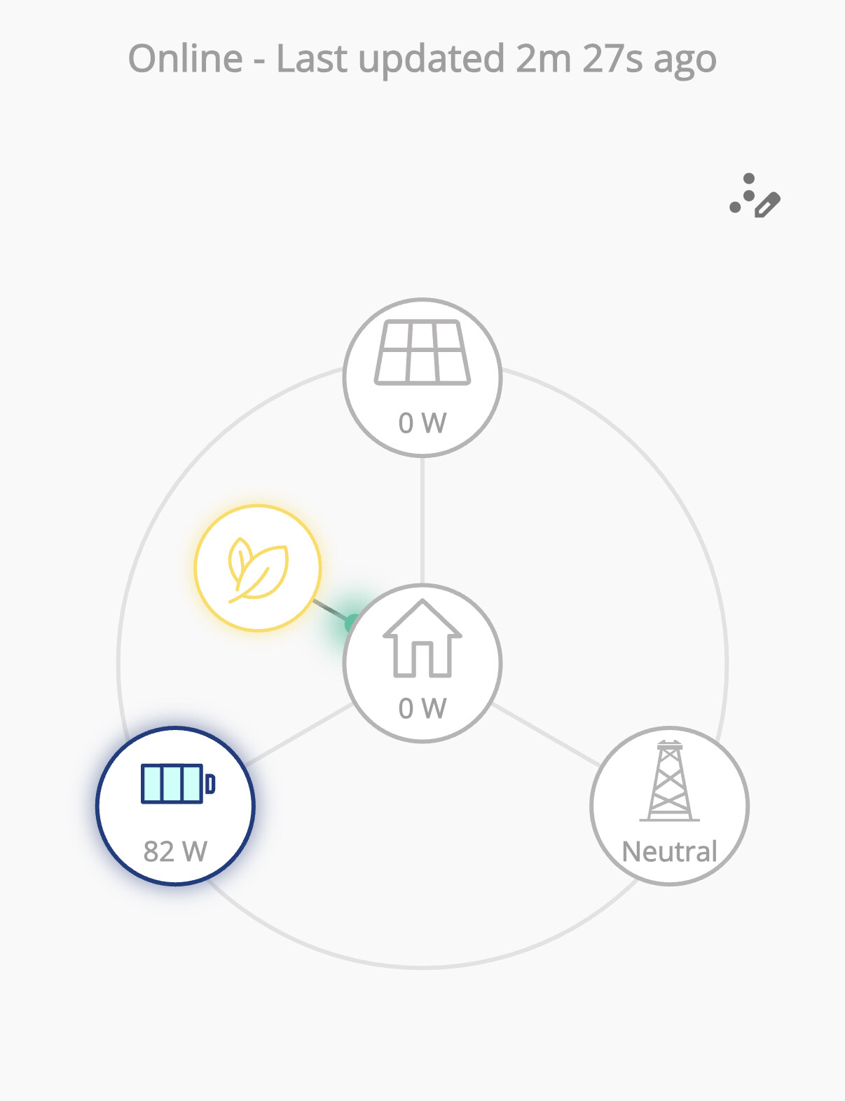

Hi, I had an all in one and solar installed about 3 months ago. It was all working fine until a second all in one was added to the system last week.
Now the system doesn’t function at all. The battery is constantly consuming 80-100w even though it’s showing as fully charged, grid is zero in and out. If I look at grid data it’s all zeros but the grid meter red led is flashing and its counter is counting.
Like I said everything worked until the second battery, and installer is saying they are waiting for GivEnergy to book an engineer.
They’ve messed about a bit but now the system shows no grid or generation data.

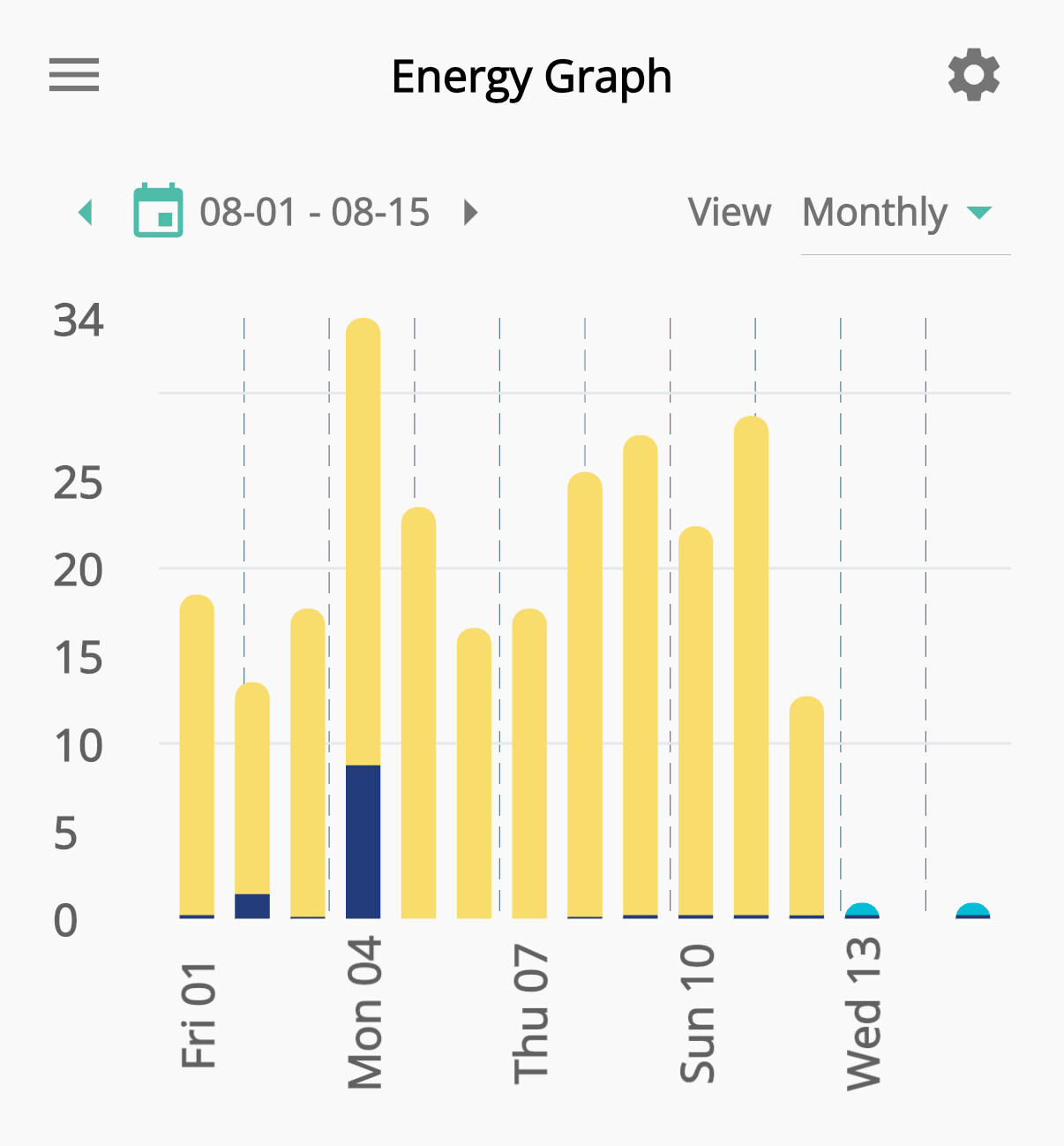

1, The meter first seen date on the portal for the grid meter changed to the day of the new battery install, but the generation meter which was still working at that time had not changed first seen date. Now the generation meter is also not working, or showing data, its first seen date has also changed.
2, logs, all historical logs are missing from the portal

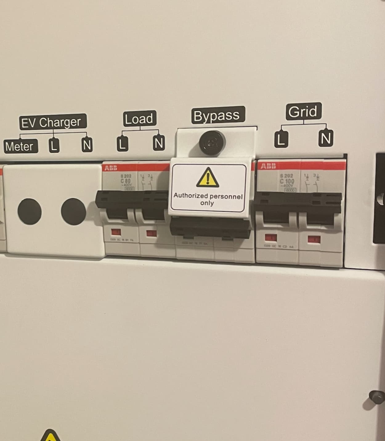

Did the installer switch the grid bypass switch back off on the gateway? Sounds very similar to the situation I had when the second AIO was installed.
Yes, that’s all good.
