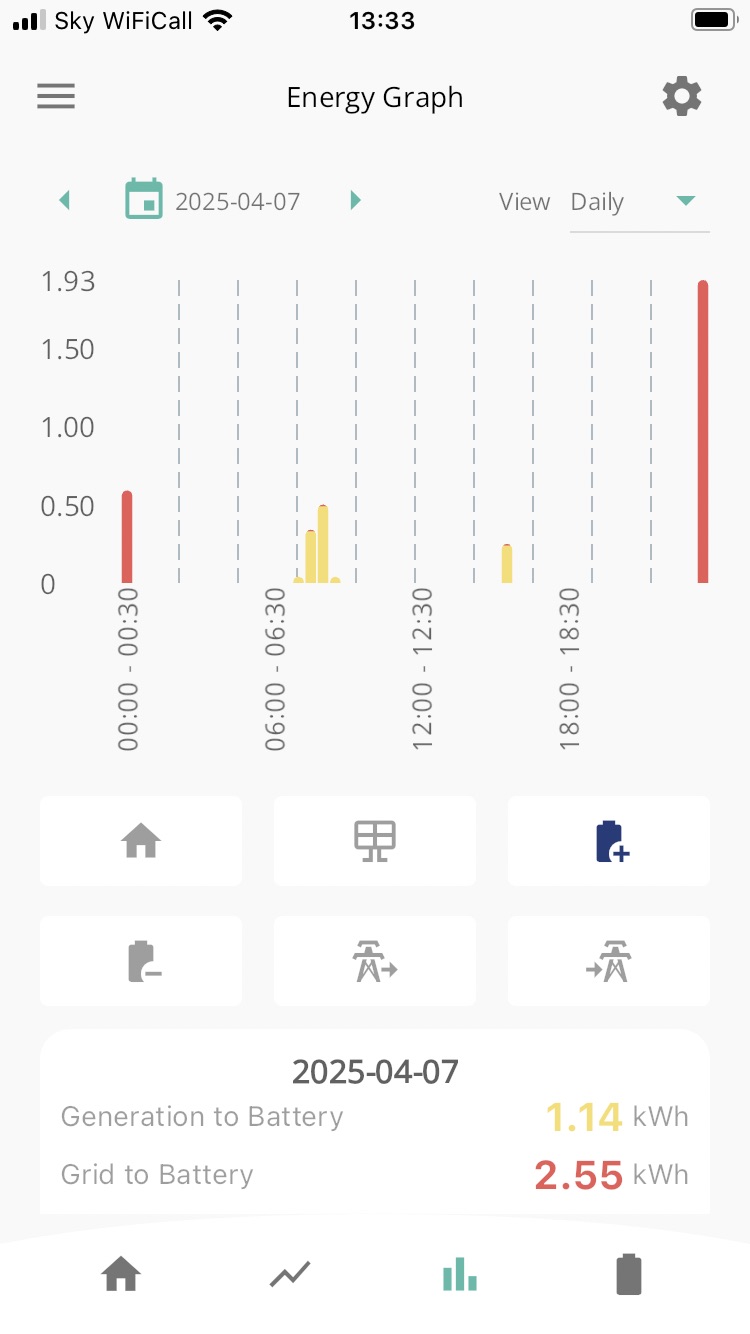

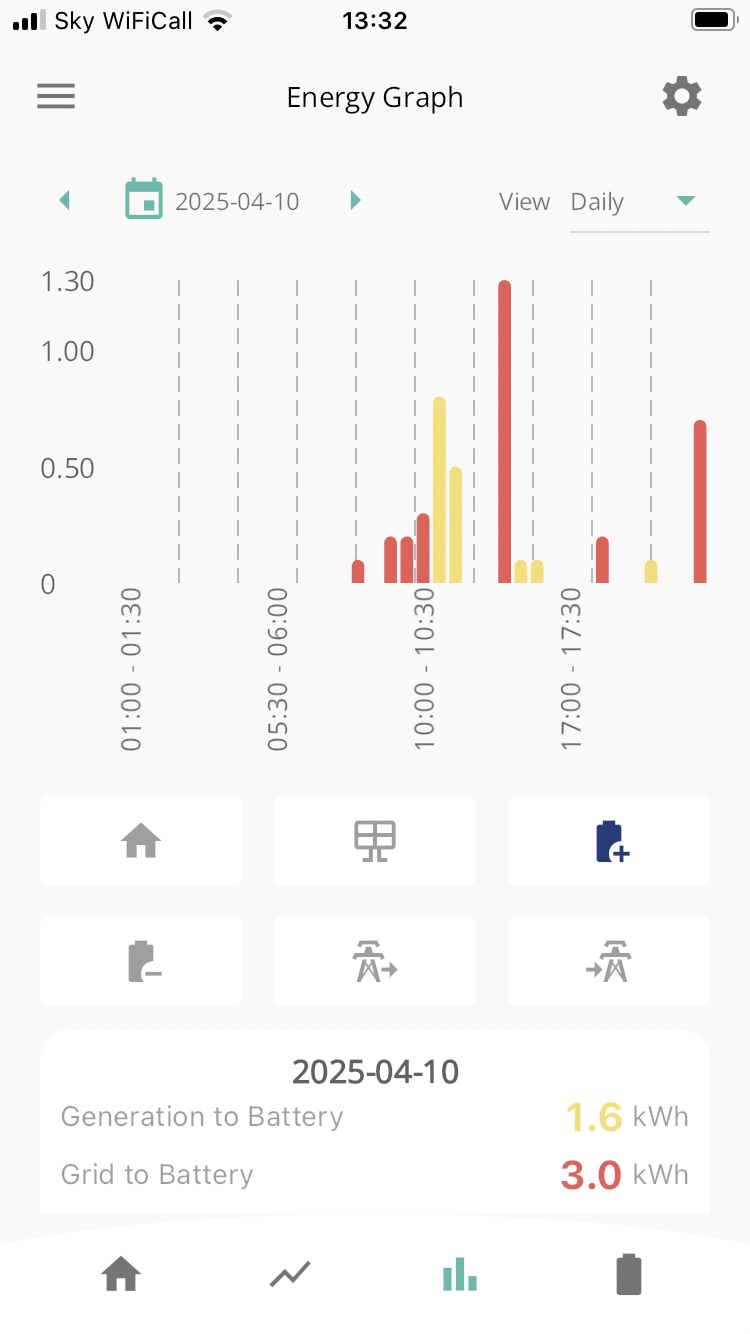

Hello - just joined - GE Gateway and AIO installed last May. 10 Solar PV on my garage. All working nicely but had a few queries recently. Appreciate any input.
  1. GE app has been showing GRID to battery on certain days - the opposite of what it should be doing. Understand there should be a small trickle in this direction but here I have been seeing several kW (see attached screen shot - shows 3 kW). I waited to get my Octopus smart meter bill (on Octopus Go) and on that day it shows nothing like that volume of GRID coming into the house. So the app is showing something odd that does not match the GRID smart meter data.

I am not sure that would be the issue as it would show GRID to battery all the time / more regularly if the clamps were not in the correct position. Attached phot shows a different day in the same month looking more like what I would expect.

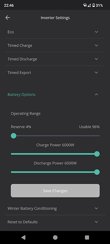

Check your charge / discharge limits on the AIO. If demand exceeds the discharge rate it would pull from the grid.

Do I check those charge and discharge via the GE App? I only have timed charge set for cheap rate. No limits on discharge activated.

Charge and discharge rates can be seen in the app or web version.
In app it’s settings cog, battery options.
If discharge isn’t capped and demand isn’t exceeding your discharge limit + solar generation I’m really not sure what it could be.

I was thinking more the charge and discharge rates just below on my screenshot. On my AIO it’s 6kwh.
Is yours at max?
Depending on your kit it might be less.
Also if your demand goes over the discharge amount and solar gen it will pull from grid.
Ah I see Bob.
Mine are both 6000W.

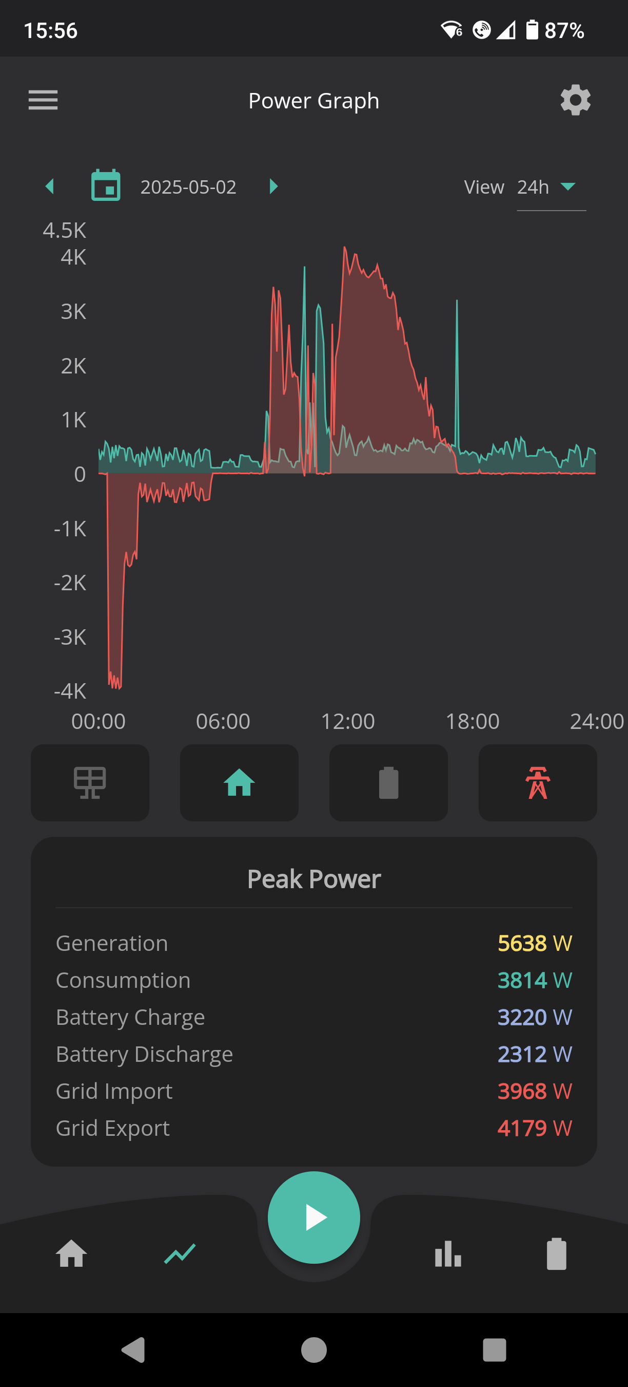

To be fair you should be able to see if house load demand spiked during similar times.
If you go to the 2nd icon from the left (power graph) in the bottom of the phone app.
Go to a day where you see grid draw and see if load spikes up. At same time. You can filter to just grid and load to make it more obvious. I would expect to see battery dip as low as it can if it’s discharge rate is maxed out.
Just take the GivEnergy power graphs with a pinch of salt.
The data is only captured in the portal/app from the inverter every 5 minutes or so, so its quite possible that spikes such as from a kettle boiling or the oven coming on won’t be seen.
