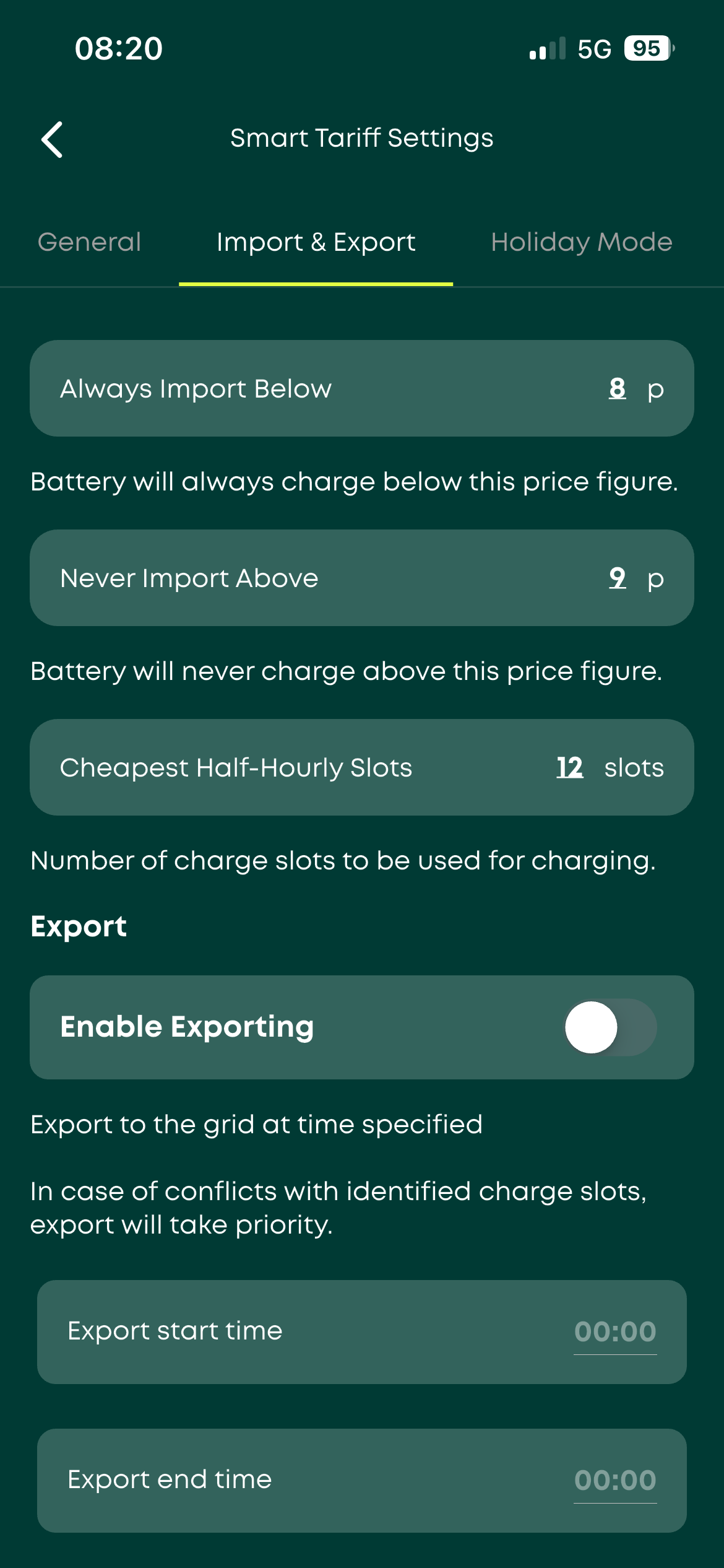

I’ve made the same settings as you and enabled it…so I will see what it does over the next few days - most interestingly when I plug in the car and get windows outside of the overnight period.
I think it was never import above this price, rather than discharge. So I’m hopeful it’ll just import during those windows and then discharge as usage dictates.

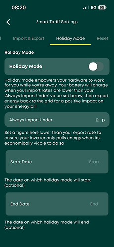

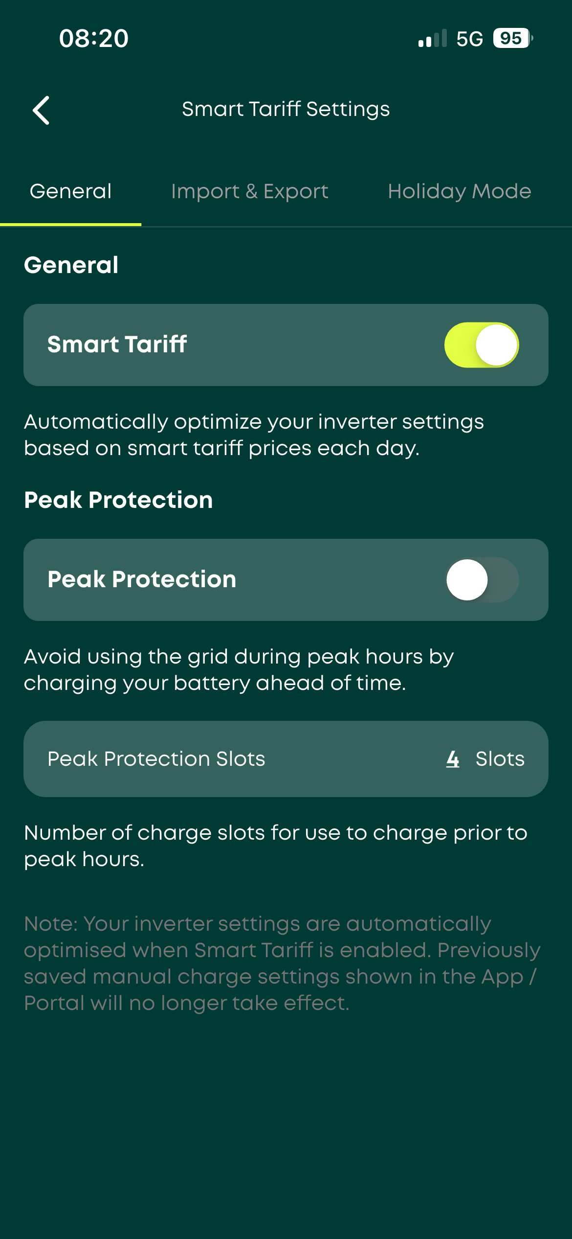

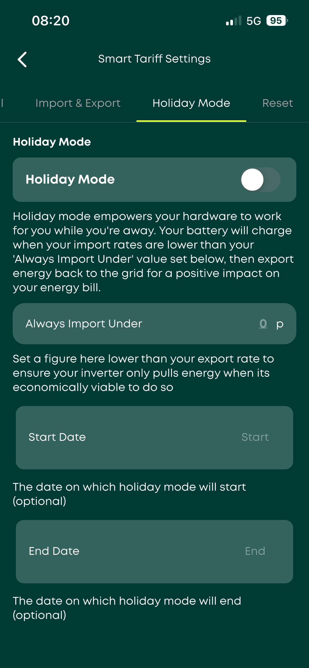

More setting appear once you’ve configured it the first time:
