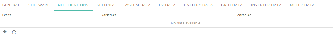

So many notifcations since update!
what are these for? there is nothing on the notifications page and they come back/multiply. highest number i have seen is 3
updated the inverter firmware yesterday…
any ideas on what it could be?
I have no idea! If I select the icon, the red circled number goes away and I have no idea what it may want to tell me. This morning I had a red ‘4’.
I used to get these on 3015 battery firmware
I think it was when the battery got a bit too high in terms of voltage, e.g. when almost charged.
Nothing to worry about as the system has spotted the issue and stopped it charging too much.
I don’t see that on later battery firmware versions - as they work differently with regards to knowing if it’s full or not.
The portal hides the over voltage alerts these days as they’re nothing to worry about, but the homepage still shows that notification unfortunately.
