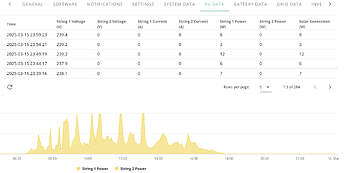

The other place to look at is the PV data, also within ‘My Inverter’. This is mine
