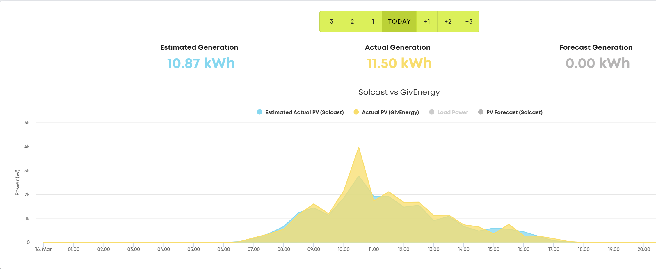

I was wondering why Solcast was off my actuals when forecasting and experiencing a fully sunny day!
Turns out, when setting up the installation on the Solcast website, if the azimuth orientation is to the East, that has to be -ve, or -1 to -179 degrees, or if West it has to be +ve, or +1 to +179 degrees.
I originally assumed it would be the other way around and hence the discrepancies.

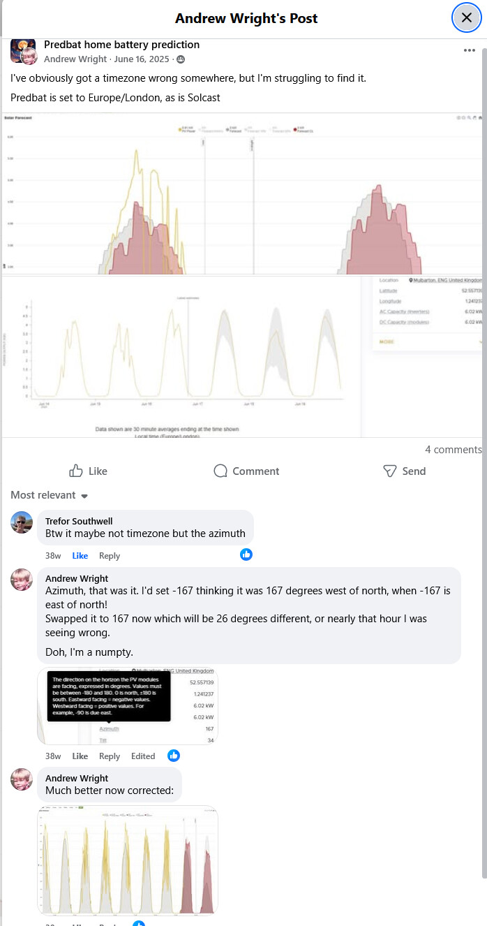

I got caught by that and questioned why my predbat PV curves were ~ 1 hr out
I’d put in -167 for ā€˜193 degrees’ when it should have been +167
giving me a 26 degree real variance or 52 minutes…
Trefor saved the day.
Yeah, I was 50 degrees off. Mine wasn’t a bad match today!

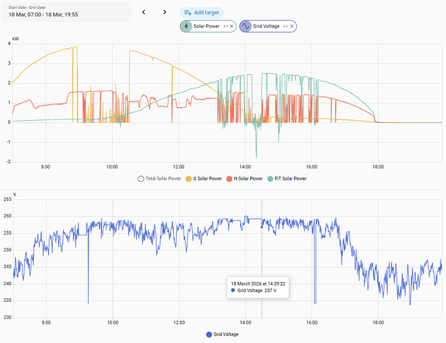

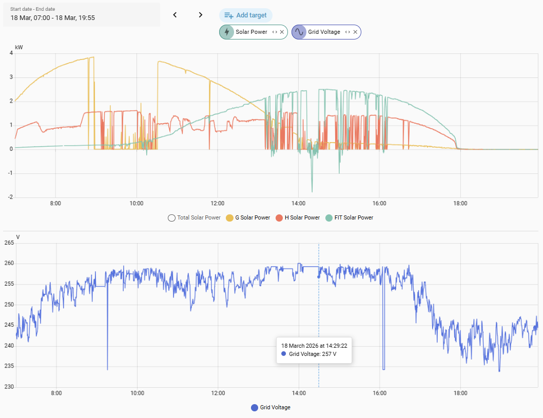

I too get clipping on my solar setup, but mine is a different problem, mine is that on sunny days the amount being exported drives the grid voltage up and that in turn shuts the inverters down. For most of today the grid voltage was around 258V, well above the 253V upper limit, and you can see the effect on the inverter power that drops off repeatedly.
Can also see the progression of sun across the 3 arrays
I chased my DNO about this issue again this morning. They’re supposed to be fitting a voltage monitor, but I know what the answer will be, they’ll need to re-tap the transformer down to a lower voltage which they did 2 years ago but the problem has got worse again

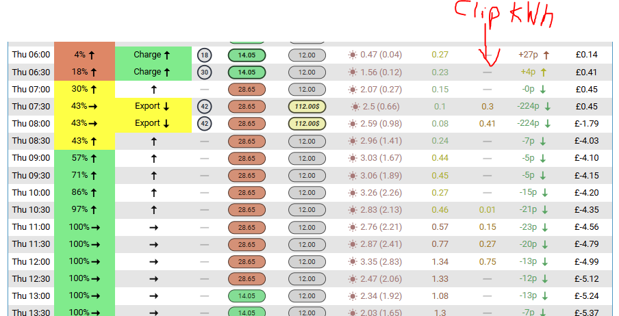

Its not particularly covered in the predbat documentation, but if Predbat detects that clipping will occur it will reduce overnight battery charging or where necessary will export the battery earlier to give space to avoid clipping
I have artificially reduced by inverter throughput limits to encourage predbat to do this more, and you can see clipping being identified both at the peak of the day and during the Axle session export:
