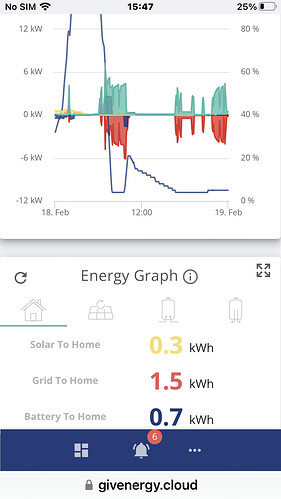

The reason I ask about strings is battery never gets to 100%.
On a sunny day on the panels it can be around 600w generated on the app, this morning cloudy says 86w from 10 panels don’t sound a lot or does it.
I look on GivEnergy cloud ap not sure what I’m looking at but I go on solar it says something like
Vpv1 422.2
vpv2 0
Ipv 0.1
Ipv2 0
I was just thinking if vpv 2 or ipv 2 was a string from solar panels then it’s always on
‘0’ from the day it was fitted March 24 that’s why I use more electric than panels generate

From your screenshots, it looks as if there is hardly any solar energy being used to charge your battery. Most of the time, you are running from the grid.
Please do this on the portal, rather than from your phone.
  1. Go to Inverter/settings.
  2. Make sure that you have ‘Eco’ selected.
  3. This may get your system working as it should be.
  4. If this fails, select the restart inverter button at the far right at the top:
  5. Review what has happened.
If you are getting no further you need to talk to Givenergy.
They can look at your system and hopefully fix it.

it does look like you have all 10 panels on a single string.
Having more panels on one string isn’t a bad thing, you need a minimum ‘startup’ voltage from the panels for the inverter to start supplying AC power. I couldn’t find the spec sheet for the Gen 3 inverter you probably have, but for the Gen 1 its 140V and the Gen 2 its 150V.
It is generally advised to have panels that are on separate orientations to be different strings on the inverter, that way as the sun moves around each string can operate independently. However if your installer had done that, with only 5 panels, you would find more occurrences of there not being enough solar to start AC conversion.
Looking at the screenshot above, VPV1 is 403V, so if that was halved, you’d only just be above the startup voltage
