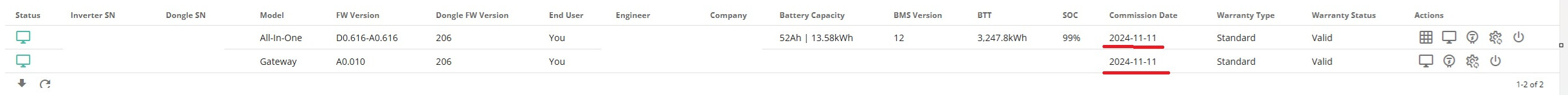

It’s not really a solution but I had similar behaviour when my system was only partly provisioned. My gateway commissioned but the AIO didn’t complete. In essence the AIO just slowly drained and didn’t function really doing much else unless forced.
Does it actually shows a commission date on your inverter page on the web version of your givenergy portal.
Edit. Added a screenshot what to look for.
Hi Bob, Thank you for sharing the screenshot. The system appears to have been commissioned successfully at the backend on 30th April. I wonder if the physical hardware has been correctly installed. I have raised a case with the GiveEnergy support team.
