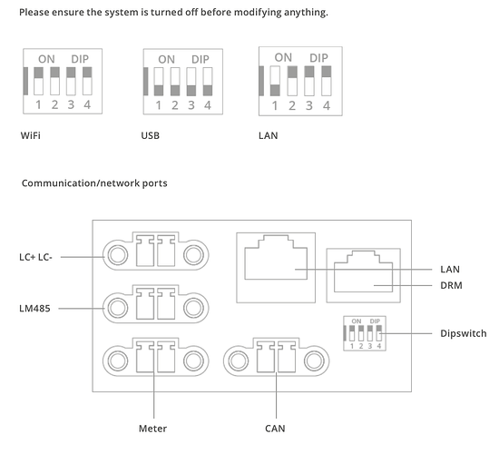

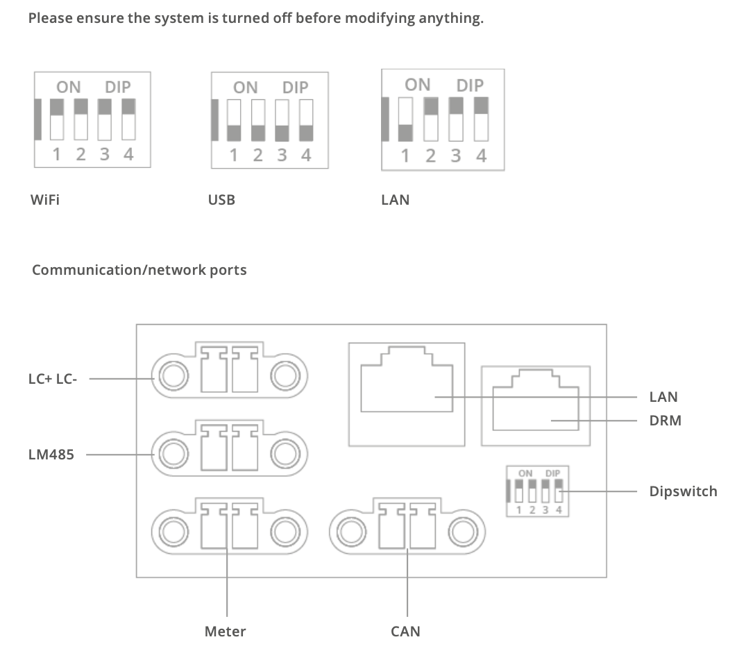

I’ve had a Hybrid gen 3 installed which I wish to connect to LAN. The switch settings in the install manual (included) are labelled as WiFi, USB and LAN. At the moment they are all ON which should be internal Wifi, however a USB dongle is installed and working ok.
Before changing anything can someone using LAN confirm the setting?
Also why is it necessary to install a dongle if there is built-in wifi?

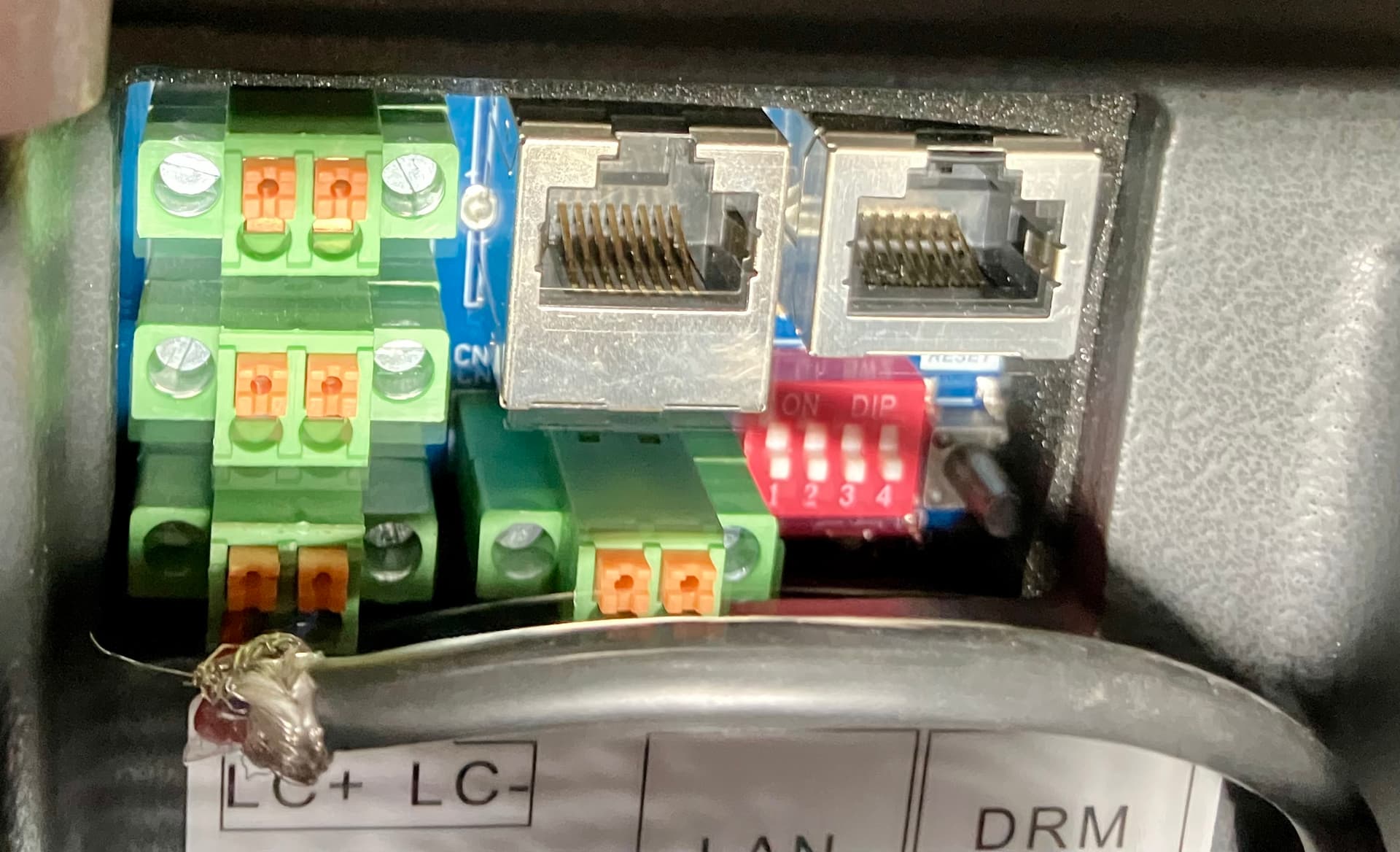

Correction all switches OFF which explains why the USB dongle is working, was looking in a mirror! There’s a button next to the switches, is that for resetting the internal Wifi?
Yeah I think it’s to reset the WiFi
Don’t forget to power off the inverter before changing the dip switches - as they only take effect after a shutdown and start up.
