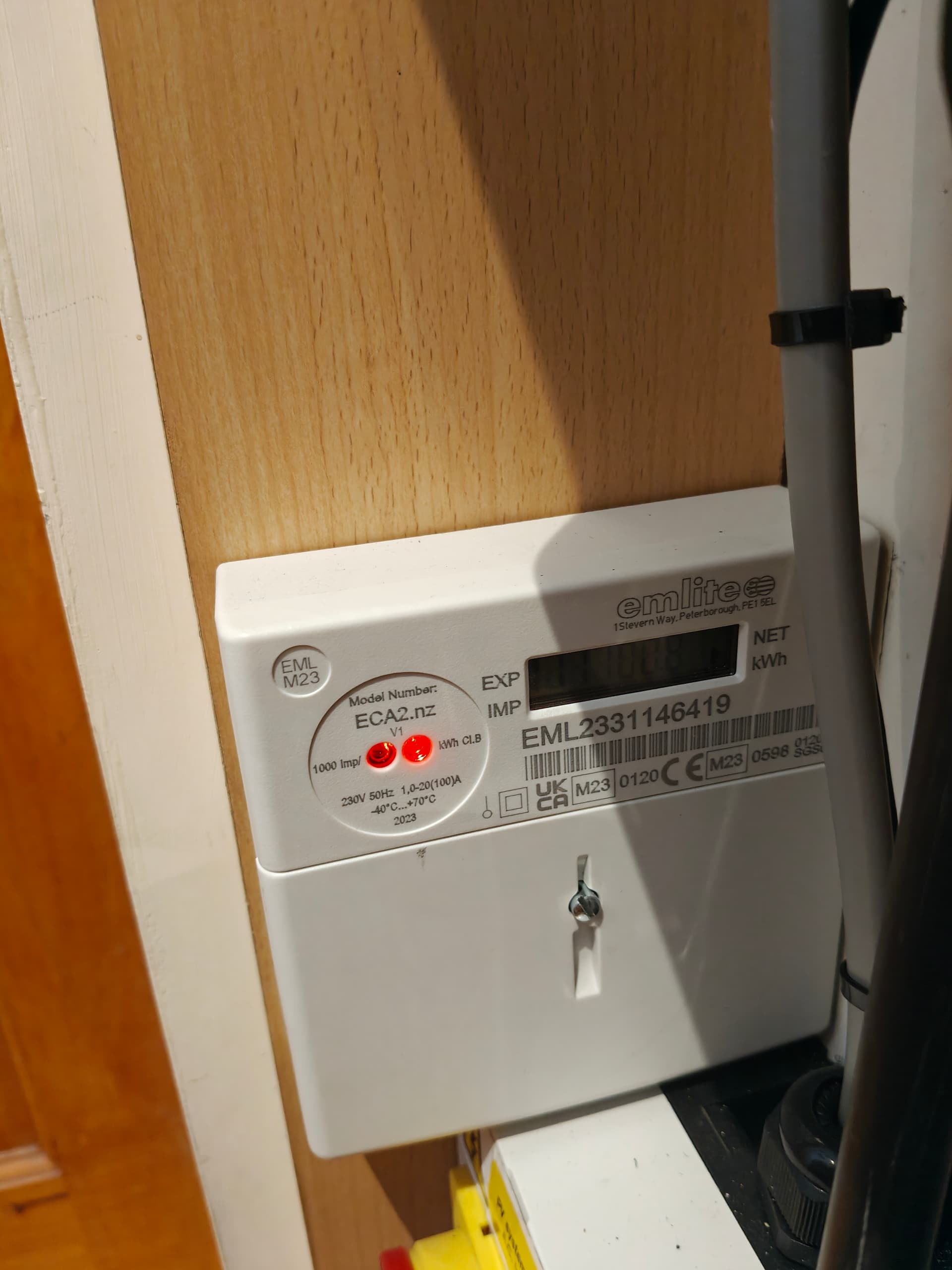

Thanks, I think I will need to get someone in to look at the system. The breakers are on but the meter next to 1 of the breakers is still showing red.
thats the MCS generation meter. Usually between teh AC supply and the inverter.
So if this has power and the Inverter is not seeing any. It will need the installer with a multimeter to see where the connection has failed
