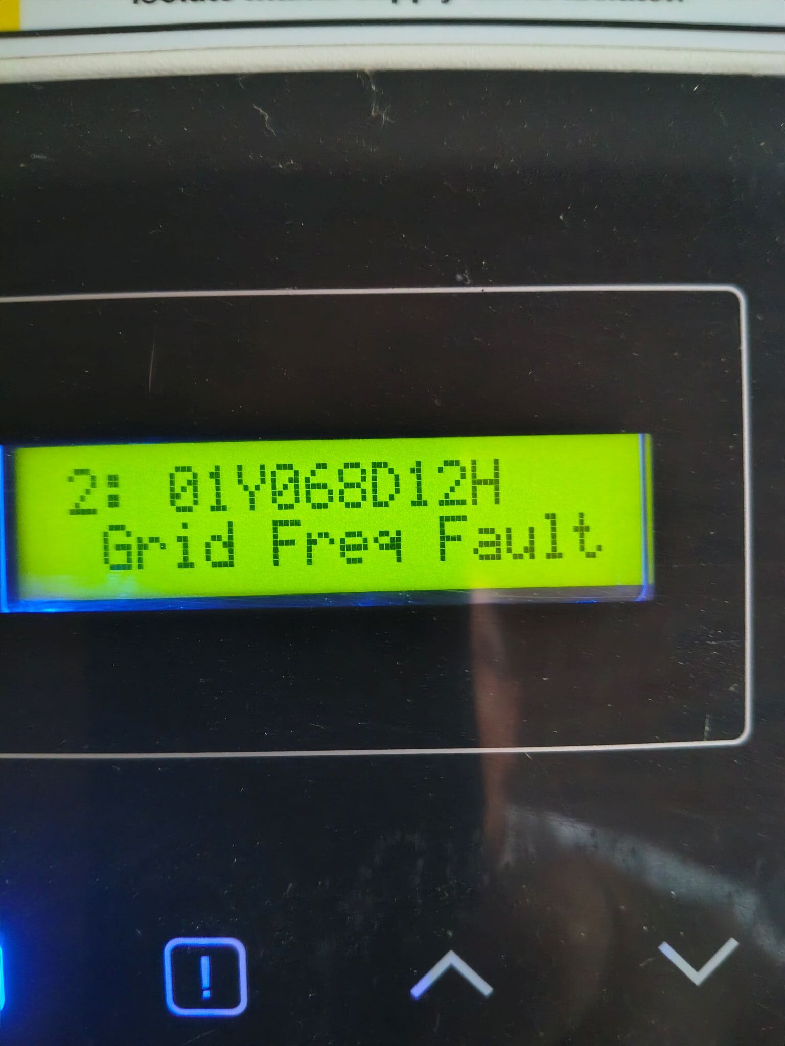

Today we had one of the ring main circuit trip following this error on the inverter display. Total of 9 instances today at time of posting this.

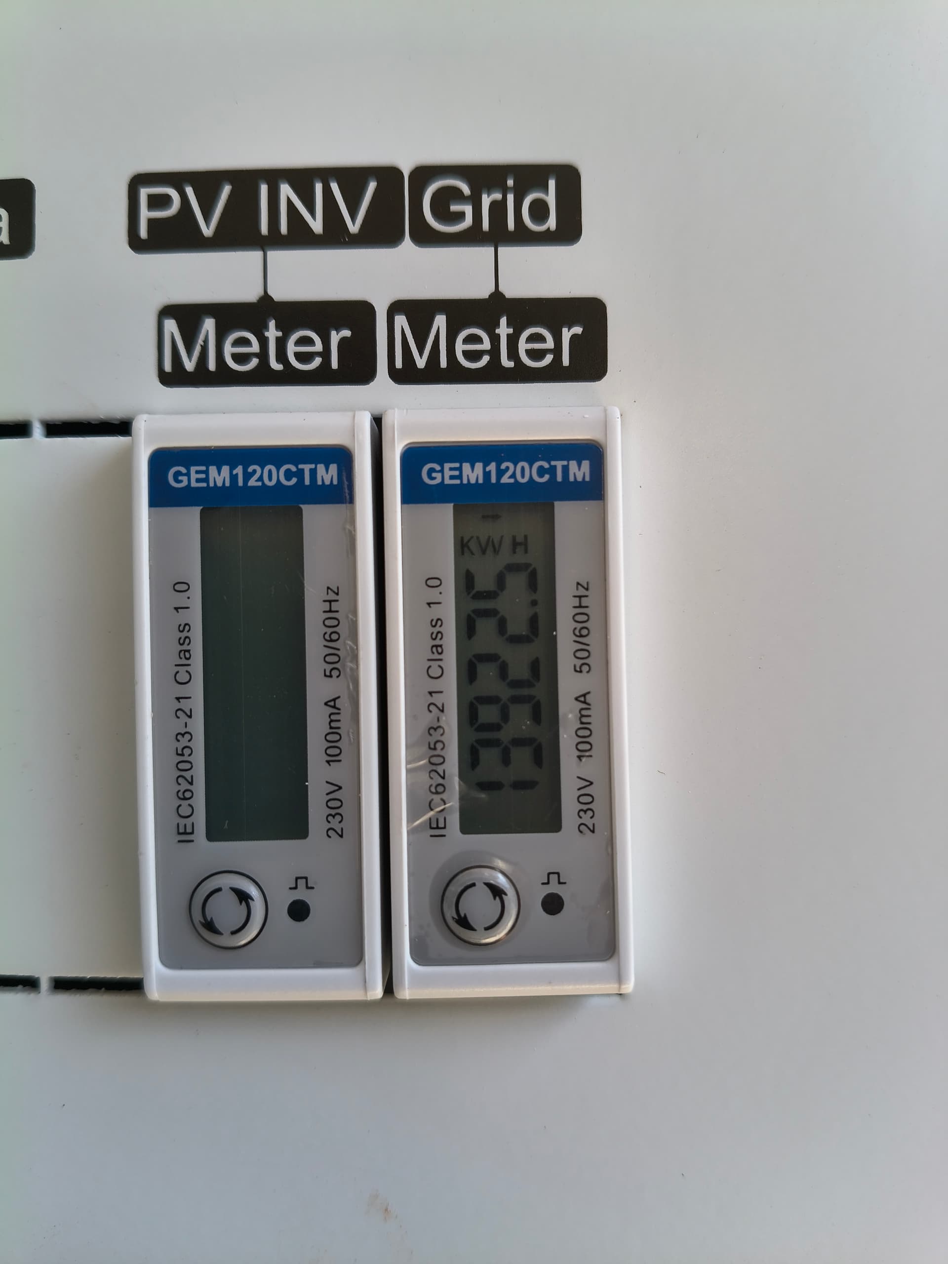

Also got this in the Gateway box, meter module just flashes 888888.

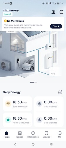

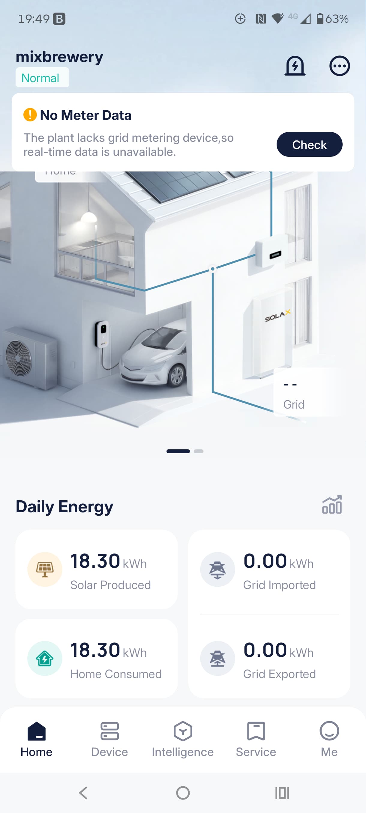

Have now installed the SolaX app on my phone and connected to monitor what is happening.
Solar is being generated by the panels but is just going to the house. No export since Sunday.
