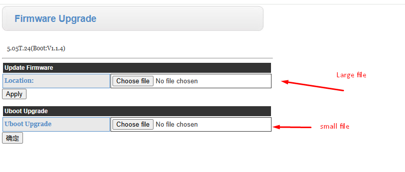

You an update the chipset with hese 2 files inside the zip with a guide
https://givenergy.co.uk/wp-content/uploads/Chipset-v27-Boot-1.14.zip
