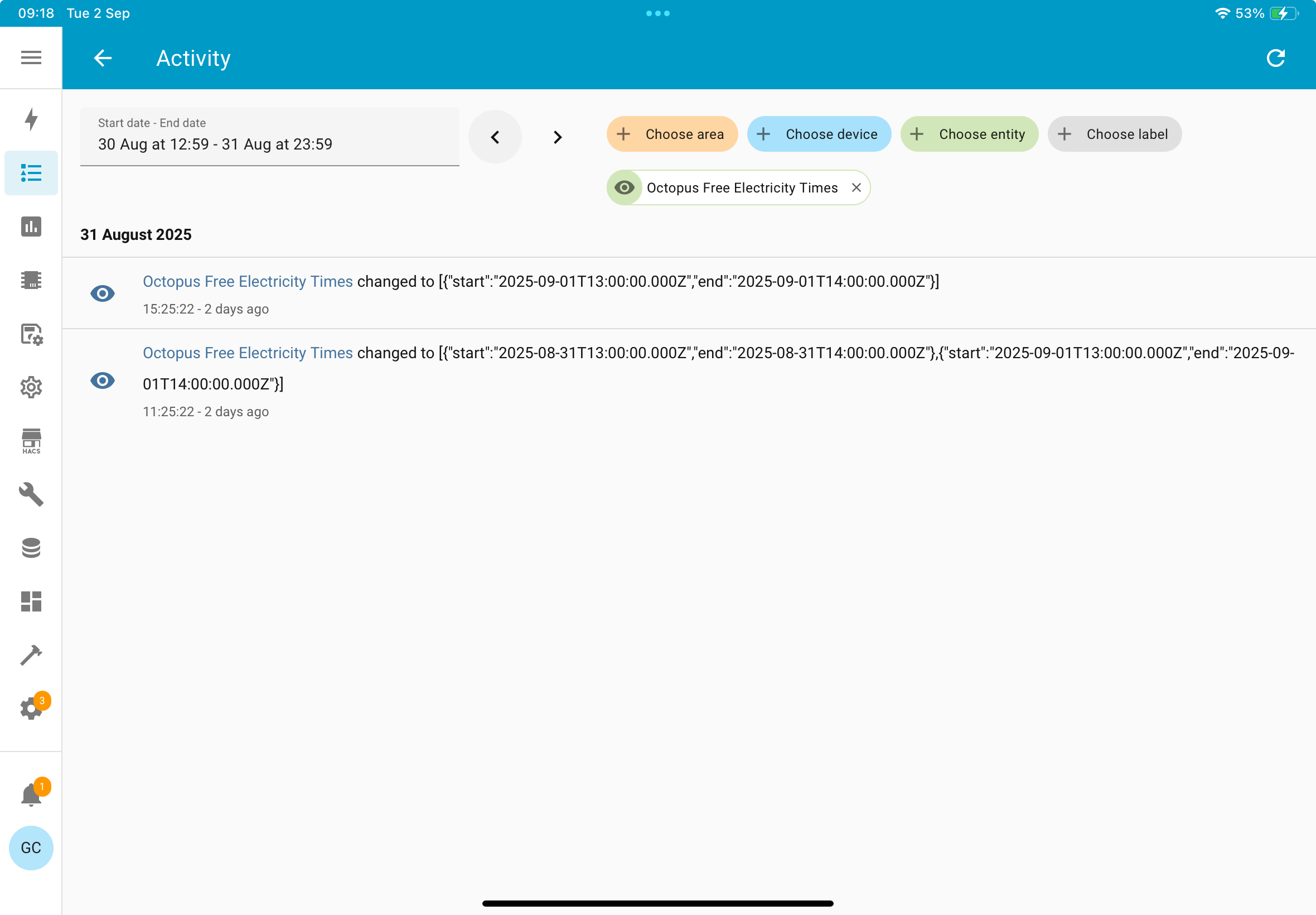

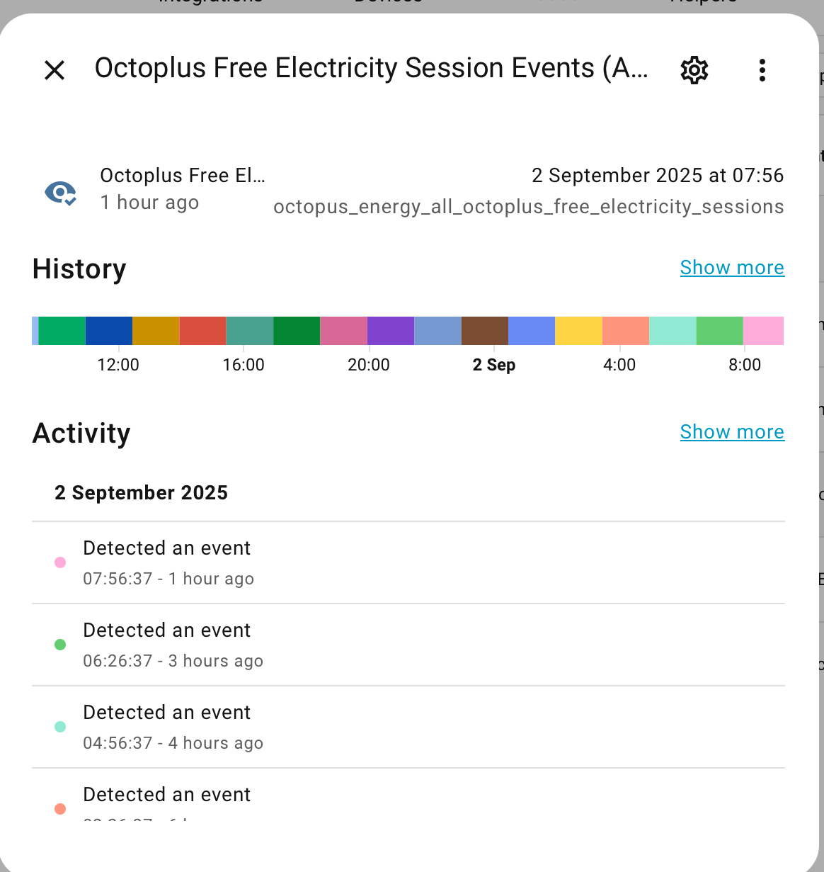

I can’t really help you with the automation as I’ve never tried using event triggers like this.
In my HA I see the Octopus events trigger on a very regular basis, for the free electricity, its every hour:
Am guessing that they trigger every time the integration polls Octopus because other events such as import rates trigger more frequently.

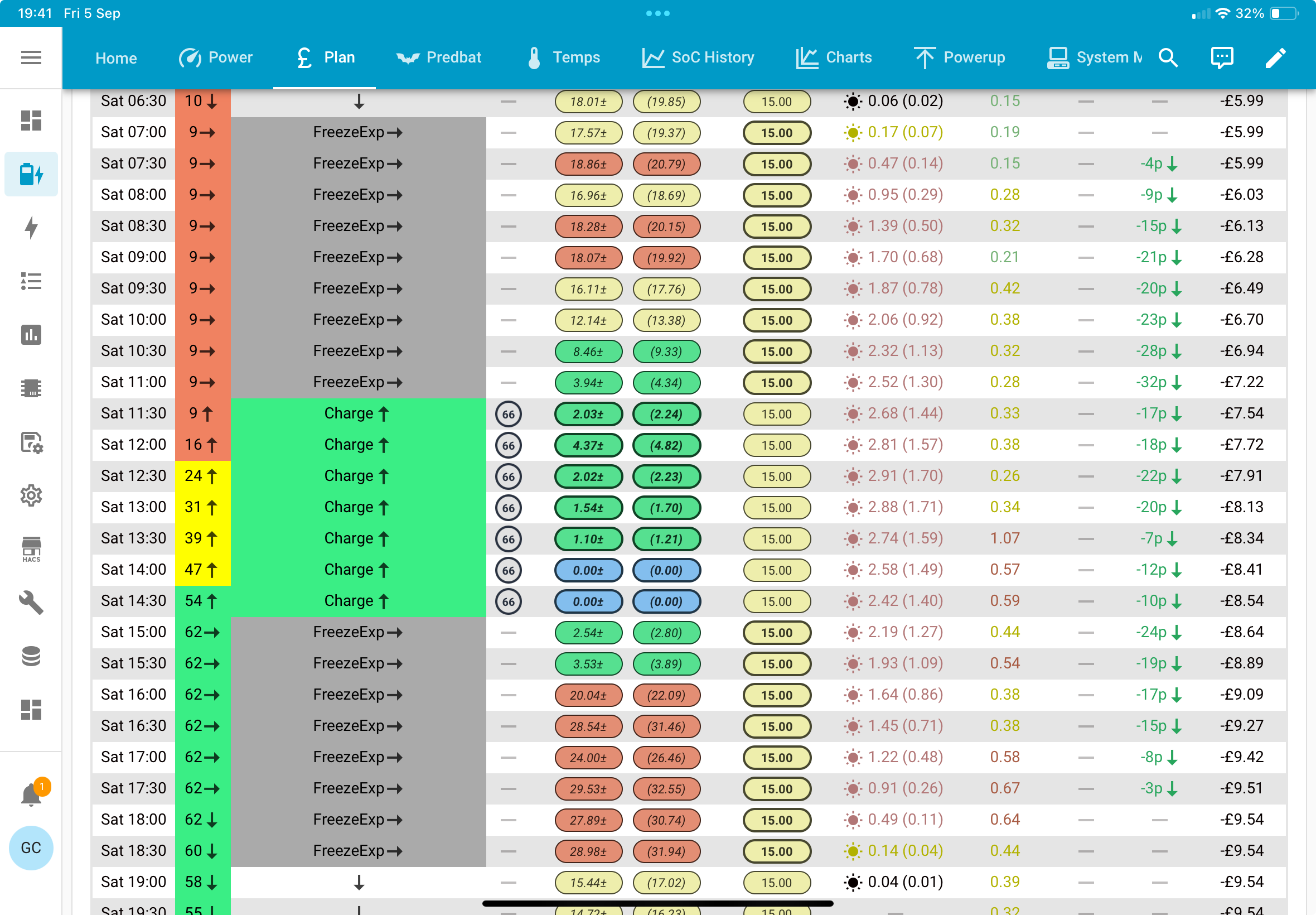

Predbat has picked the free session up automatically for me tomorrow, and although its planning to charge, in reality I expect I will be exporting not importing as I can only charge 2.4kW into the batteries each half hour and the solar forecast is for more than that.

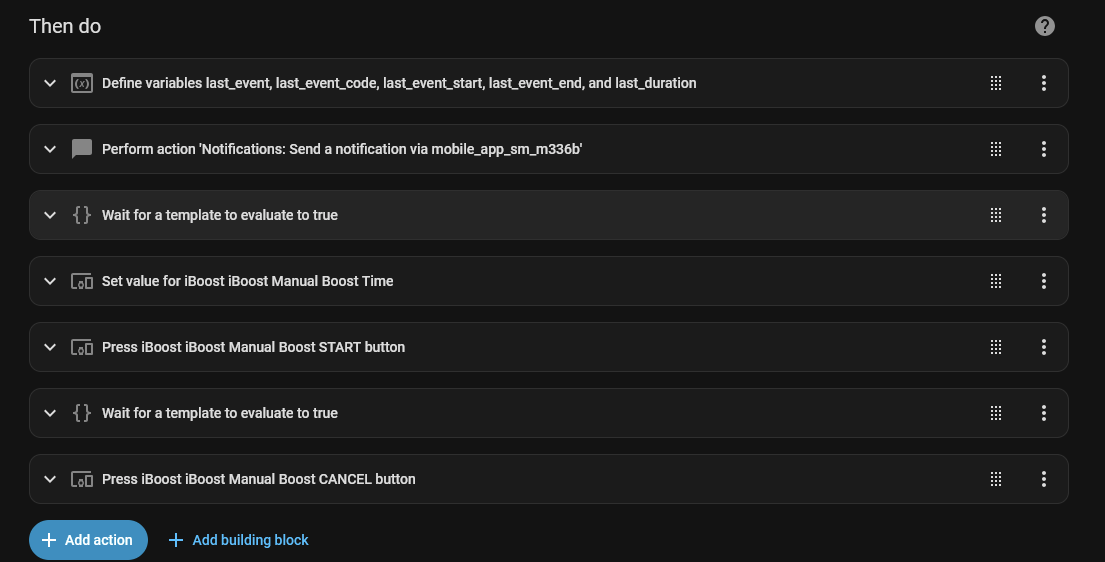

Here is my really simple automation now that has a delay and loop so that my iboost+ works as I want, and now if does work I am also going to add additional tasks when Power-ups happen so that my AirCon comes on and will either heat or cool my house for free ( as why not just use the power when it’s free )

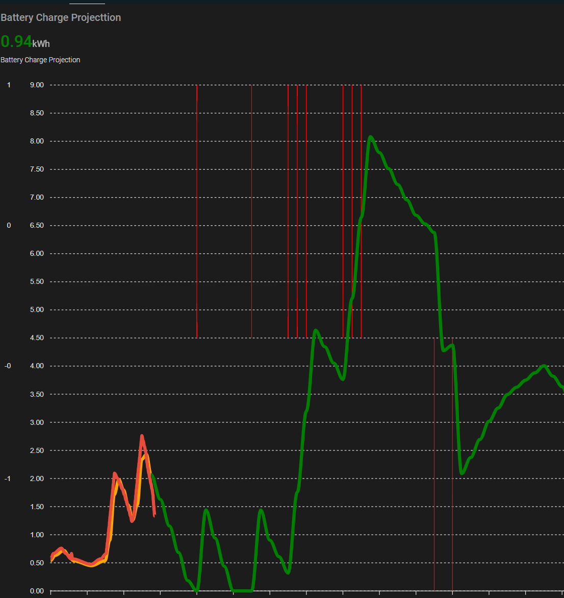

Home brew plan using genetic algorithm, upper red lines import, lower export, green soc. So stops charging at 5am exports during breakfast, then the sun kicks in.
