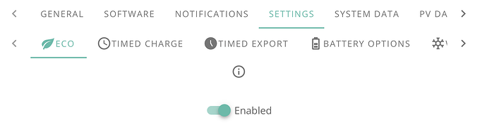

Eco
Also check your Settings. ECO should be enabled.

Thanks for the feedback. Unfortunately the reboot didn’t make any difference and yes we are set to eco. We haven’t had any timed events set up either.
