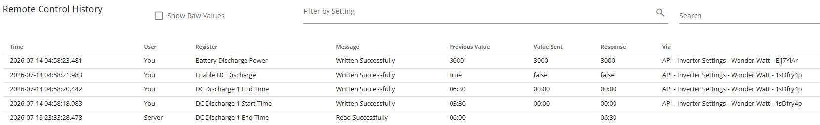

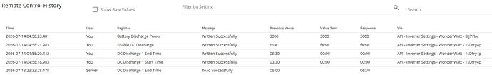

I checked in remote control logs & found reference to an API via wonder watt but I can’t find a wonder watt api in ‘manage account security’. I uninstalled wonder watt at the end of the free trial; too expensive!
Is there an api token listed on the Givenergy cloud api tokens section? If not it may be worth asking Wonderwatt about the problem.

Seems like wonder watt is still in control!
