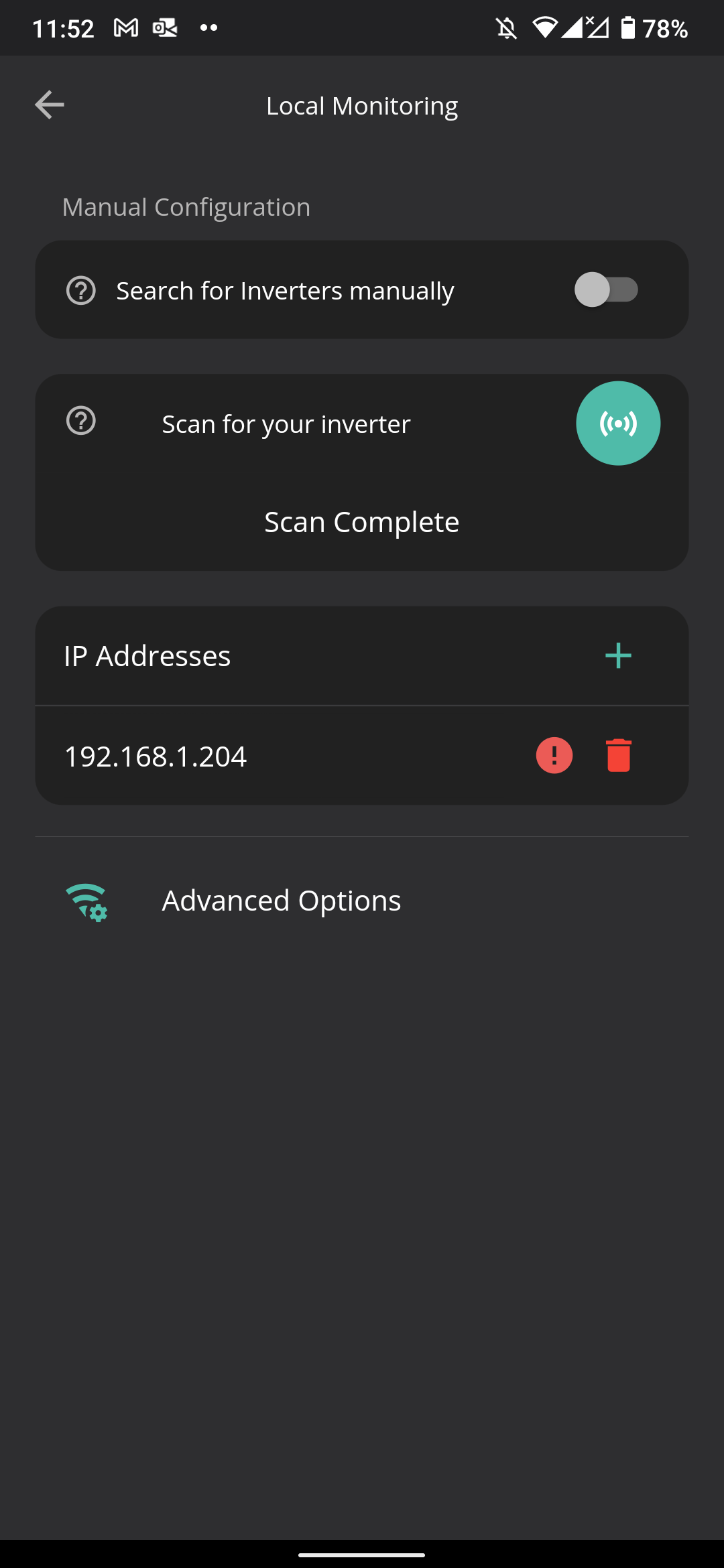

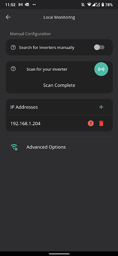

Abit of a strange one. We have a AIO which has been working fine with the GE app, however we had the power off for 5 hours yesterday and when it came back on, the app isn’t showing any values in away or home mode.
I have used IP scanner software to find the IP of the AIO and Gateway, added them manually into the local monitoring and the app is still unable to find the inverter. Scanning automatically doesn’t work either.
