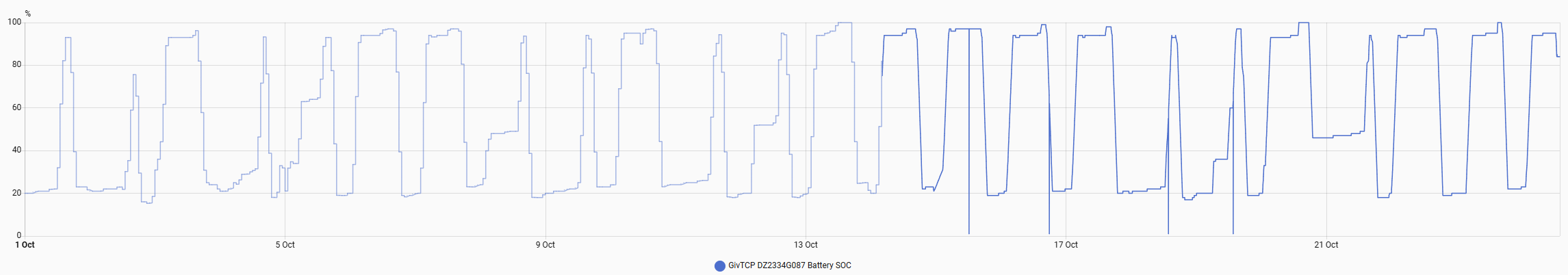

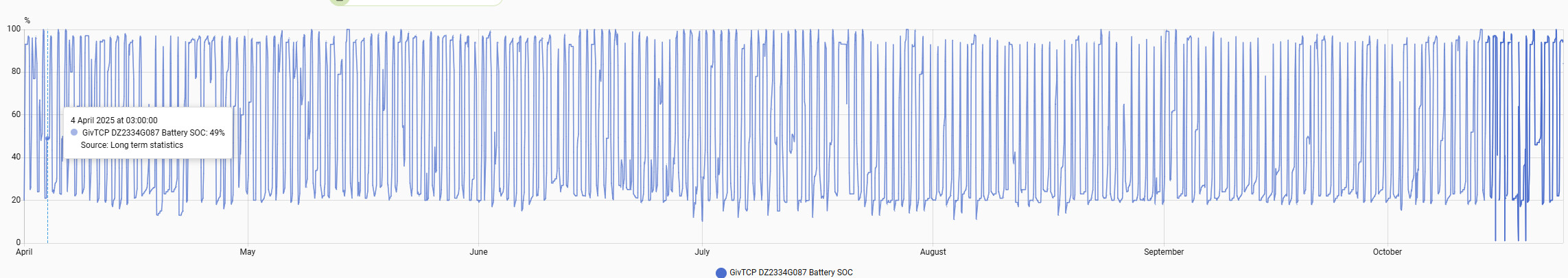

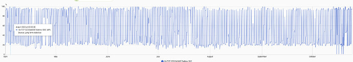

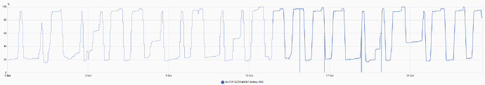

I tend to run it from 100% to 16-17% and back up to 100% daily. (one cycle a day) all year round, and see very little (none) SoC% adjustments, it just works.
It’s designed to do it, so I use it. The four dropsm on the right are data drops, not corrections (detail at bottom)

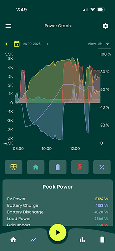

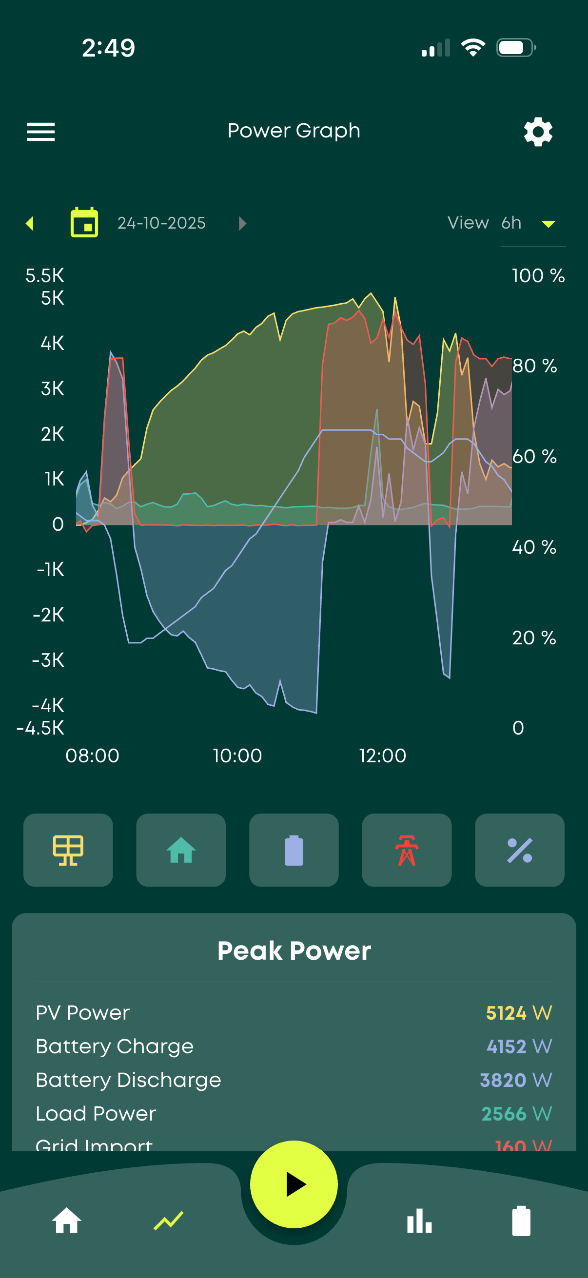

Here’s my 4+kwh drop in 20 mins.
thanks for your input everyone, I’ll see how it goes in a day or two after emptying and refilling the battery.
That pic looks fairly normal and good.

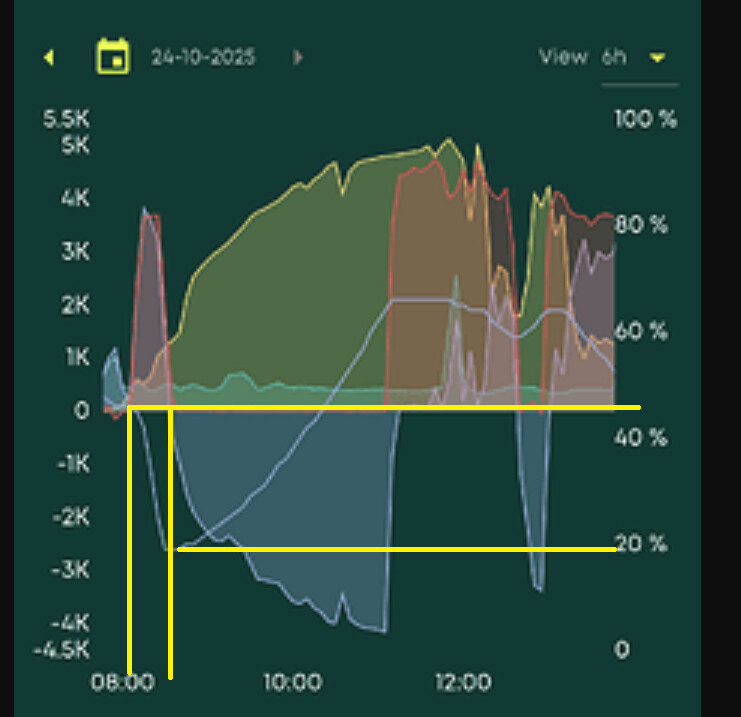

Mine? The drop of 4kw in 20 mins suggests a 12kwh discharge rate. It was only discharging at 3.6.
I can see what I guess is 45% down to 20% in about 30 mins at about 3.75kWh load without knowing the system if it were a 9.5 battery that would be about 2.25kWh.
