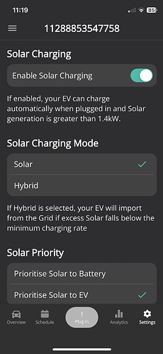

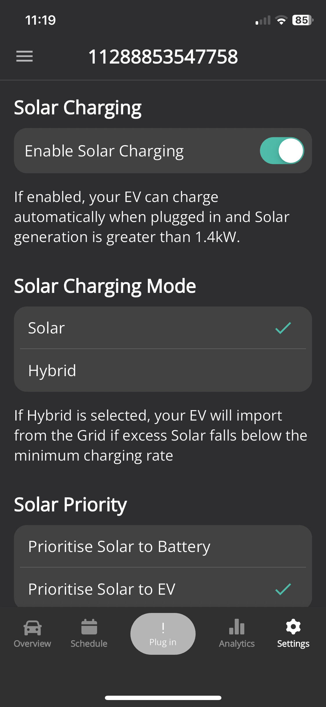

Hi.
I do exactly what you are wanting.

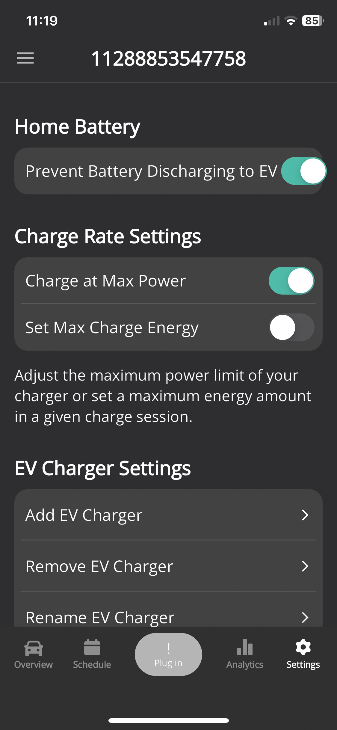

Basically, enable ‘solar charging’ , priority to EV, prevent battery discharging to EV, charge at Max current.
When the EV is plugged in and solar generation is over 1.4Kw (roughly) it will send the excess to the EV and dynamically alter the charge current as required depending on solar generation.
Your set schedule will still happen each night as normal.

If you put the settings in mentioned then you do nothing at all except plug the car in.
Do not enable plug and charge as the GW will simply charge the car if generation is over 1.4Kw and dynamically adjust charge current as required. When the overnight schedule
Kicks in it charges at full rate (7.4kW) for the period set.
You do not need to keep turning ‘solar charging’ off and on. Just leave it on.
You will notice that charge current varies depending on panel output (I’ve seen 800w to 7Kw going to the EV depending on weather).
As long as you have set the overnight schedule to charge at 32A (max) that’s what it will do for that period.
