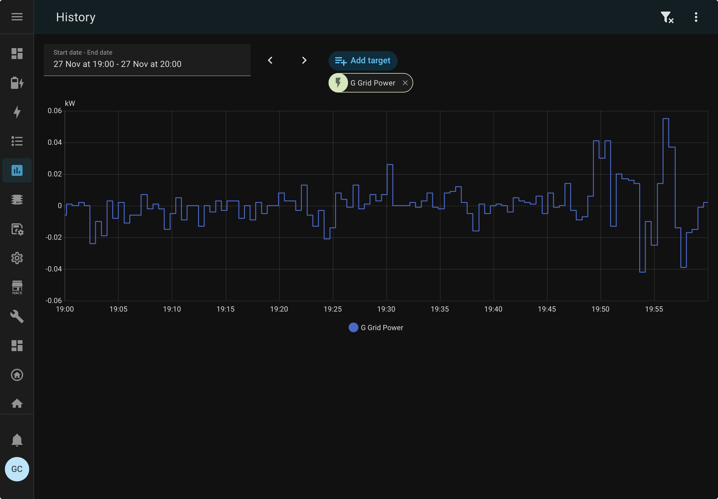

Here’s a snapshot of grid power for me, I have Gen 1 hybrid inverters with the “fast response” firmware, so they’re faster than the original firmware but probably not as good as the Gen 3’s.
This is captured with GivTCP in Home Assistant and polled every 30 seconds and generally its only small changes either side of zero, but as you can see its moving all the time.

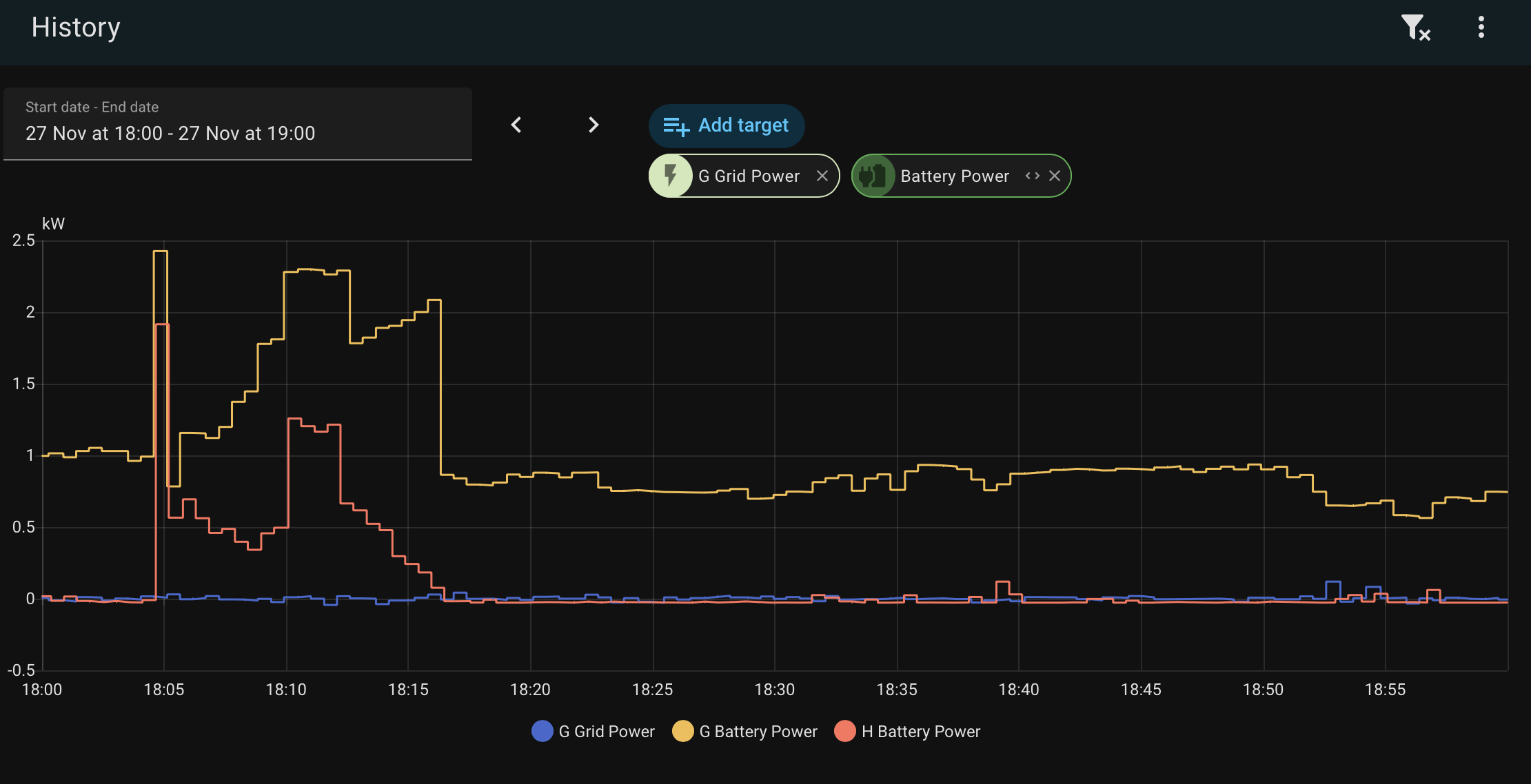

And if I overlay the battery power on top (yellow and red) you can see the context of what the inverters are dealing with
I would look at your energy bill. If its excessive peaks when the battery is supposed to be covering house load then look further, otherwise I think its all OK
