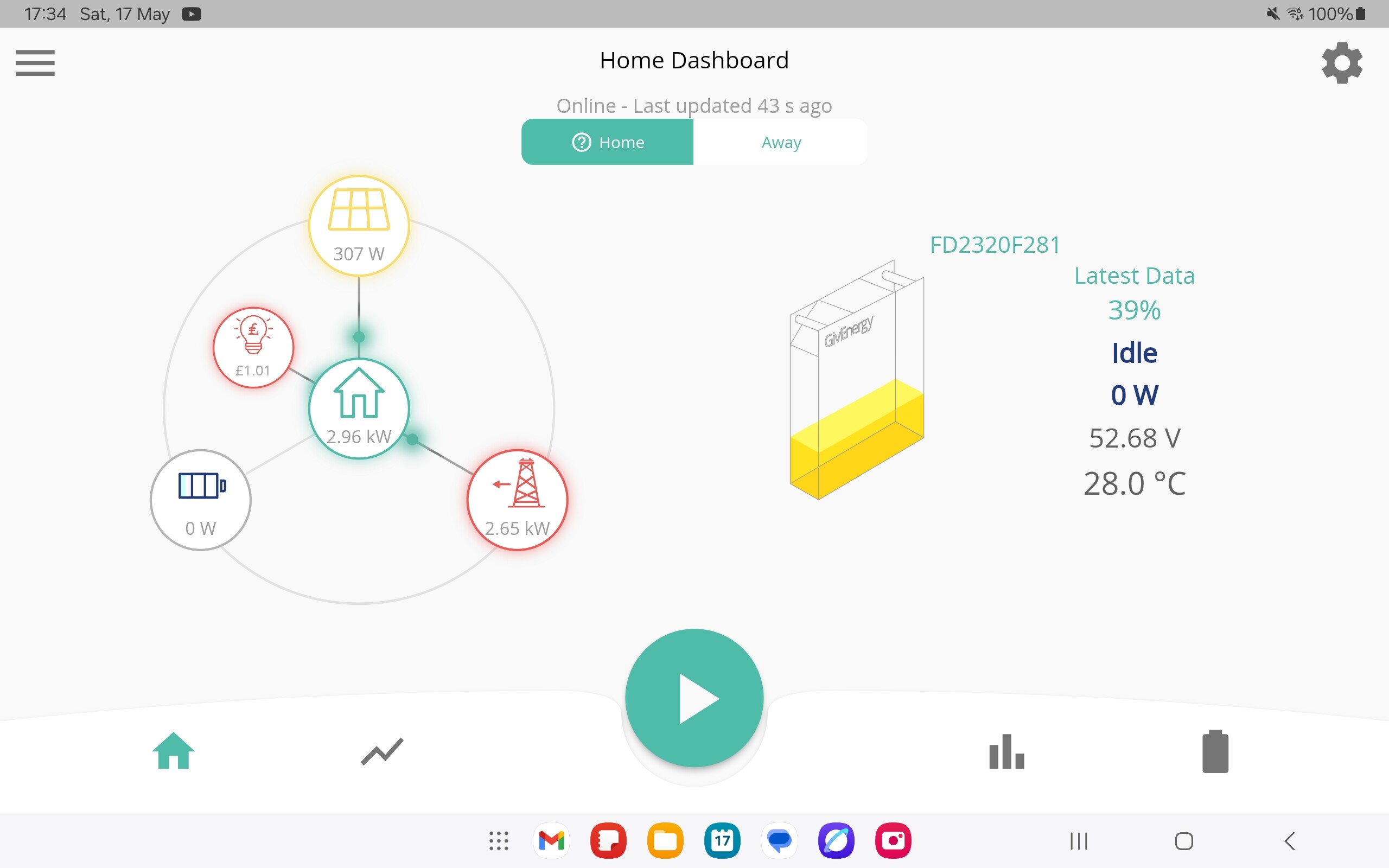

Why take from grid and not the battery?
Hi all. Can some educate me please. I have set the timed discharge to 40% (between 4-7pm (Im with Octopus)). Having just opened the App i can see the power drain to top up the PV generation is coming from the main and not the battery. Is there a reason why?. Thank you.
You’re still in your timed window. When it reaches 40% it doesn’t stop and return to eco. It goes into a hold mode. No power in. No power out. When 7pm rolls around it will return to eco.
Until then it will draw from solar and top up with grid.
