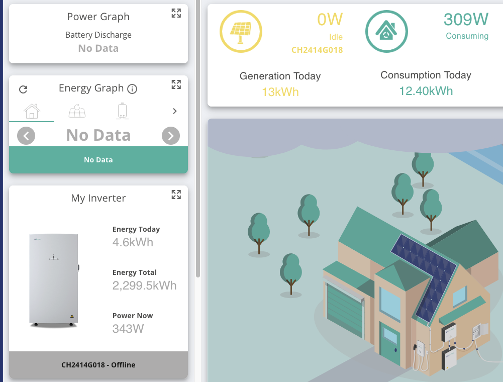

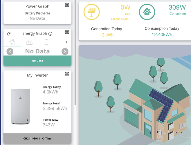

At the current moment, my AIO is offline. It almost seems that every few months, the AIO goes dark. When i say dark, i mean that both in the GivEnergy web portal and trying to connect to it via GivTCP both show the inverter/AIO as offline.
GivEnergy Web:

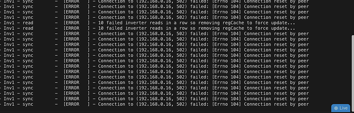

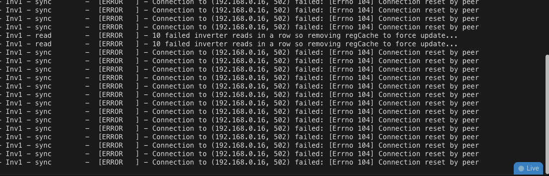

Home Assistant GivTCP.

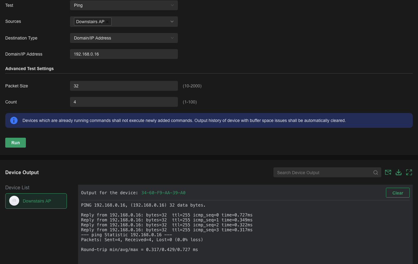

However, what the AIO is on my network, and responds to ICMP pings. (ping was sent through TP-Link Omada. I’m not on site, but one of my AP’s sent a ping to the AIO and got a response back)
This has happened to me in the past, and I believe i needed to do a hard restart of the AIO but flipping its breakers off and on. But i wonder if there is a more concrete answer for why this is happening, and if anyone knows a fix.
The AIO is connected via LAN (I prefer LAN over Wi-Fi for stability, security and control, and i refuse to accept that "Switch to Wi-Fi is an acceptable workaround, this should not be the case in any product). The AIO has a DHCP reservation of 192.168.0.16, which is what it is currently on. To me, this sounds like wherever the GivTCP server is running, it has somehow failed.
