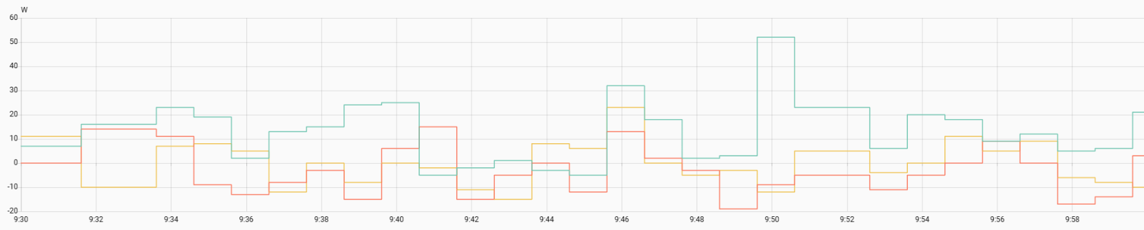

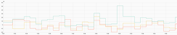

I have observed changing this setting also changes inverters ability to ā€˜balance’ with the grid. Graph below shows the behaviour of each of the grid phases measured by an independent device. The net is very often an import. Not always much but 50w over the year soon adds up!

Does that mean you’d prefer to stay ā€œbalancedā€? I guess the net loss has to be offset against the times you put a kettle on & it draws from the grid.
I think the inverter does not balance the battery/grid particularly well in either setting but probably marginally worse with the setting to allow unbalanced load. I think on balance (forgive the pun) I prefer to be able to satisfy an unbalanced demand.
I would be interested as to how well other manufacturers perform in terms of controlling net import/export. Maybe my expectations are unrealistic.
