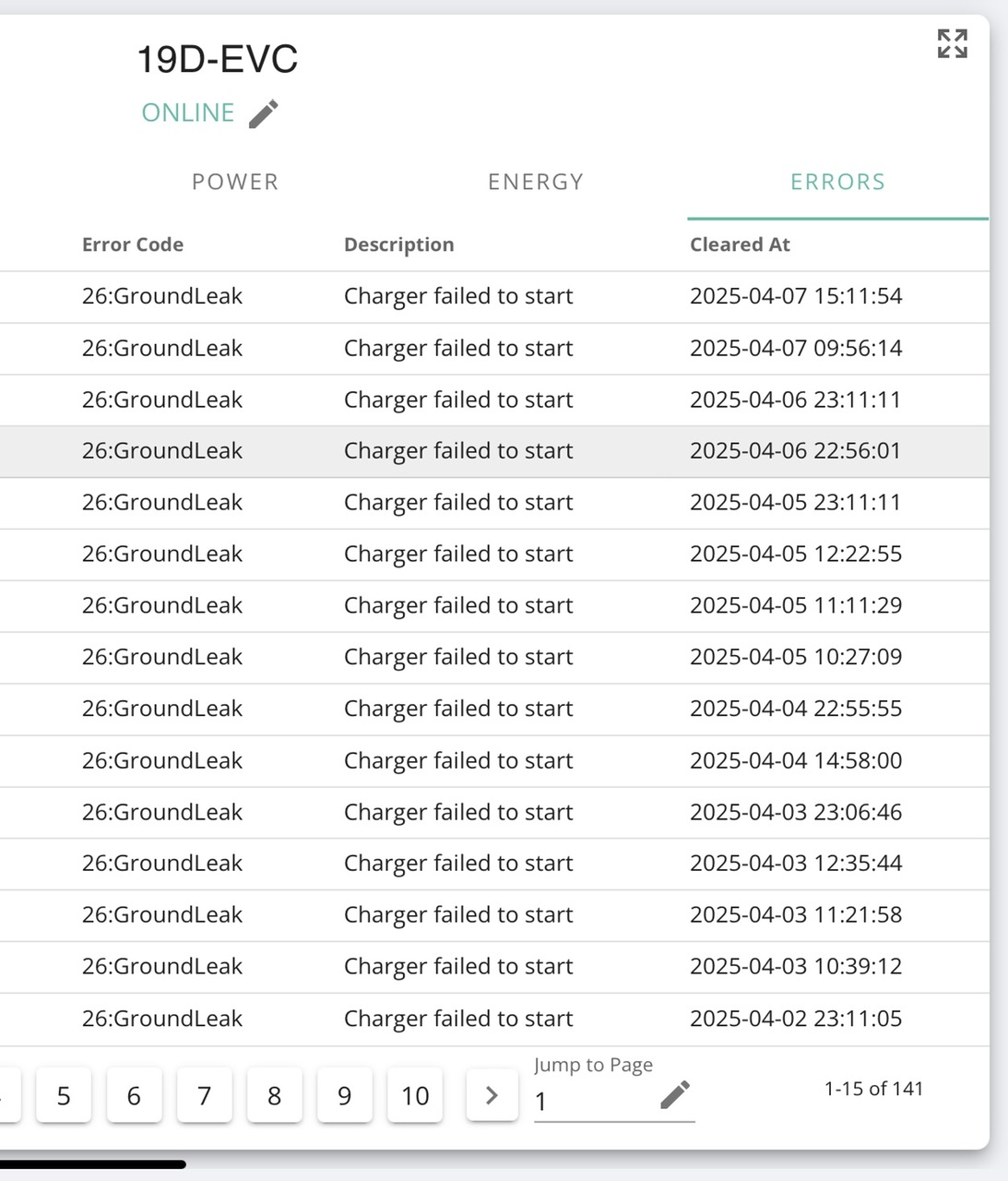

Thanks for the quick reply. Do you know if your getting and 26:ground leak errors? This can cause the EVC to shut down and have to restart? Please have a look in the cloud under Errors tab

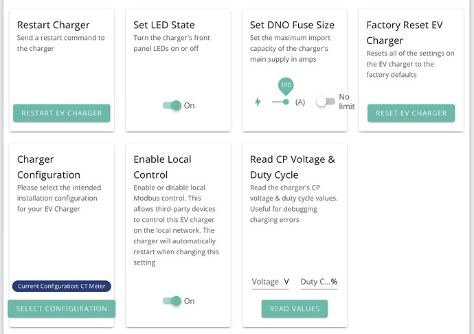

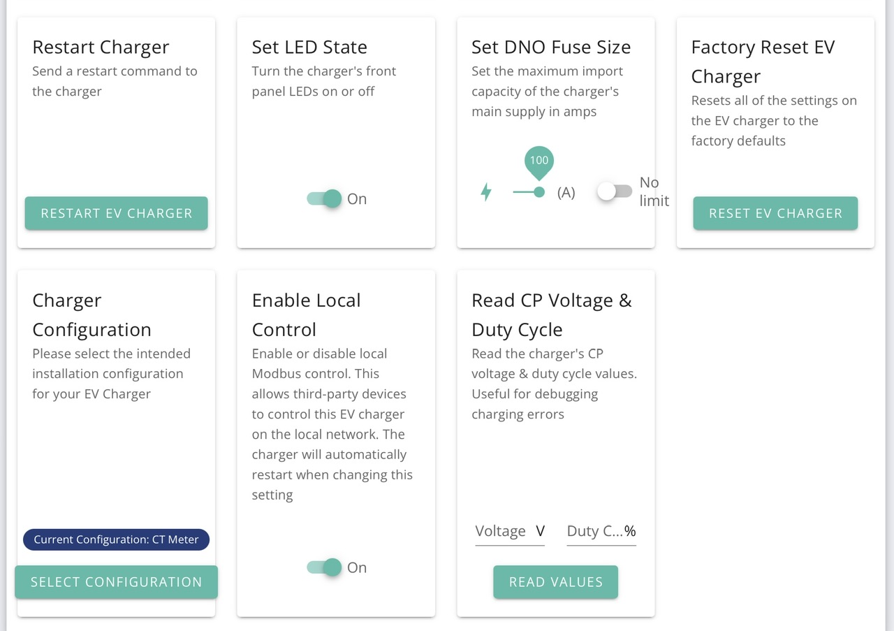

I can screen shot my EVC settings if you would like to compare?

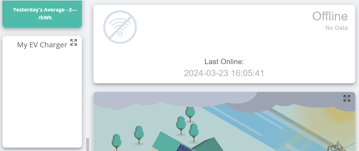

I got in and from what I can see there is actually no EV charger on the cloud!
There is no data in the inverter though its clear that both the panels and the battery are working fine. This is WAY outside my comfort zone!
Hi yeh, hhmmm that does not look good as all of your devices should have been registered with GE and appread in the GE Cloud.

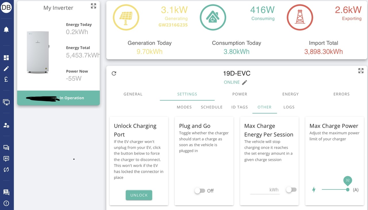

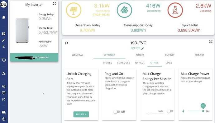

Below is what mine looks like, plus all my inverters. If you don’t see any then you will have to phone or email GE to see if your installer has given you the correct login details or did not add your devices correctly.
