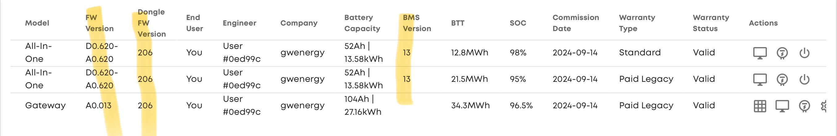

It does not look like your installer did a very good job as the FW/Dongle/BMS has not been updated either.
This is mine
