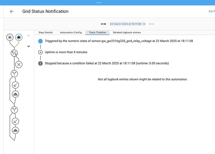

What does the Trace show?
No - this screen
It’s very easy to add triggers via the user interface, have a go and you’ll learn how they work.
The only non obvious thing is you’ll need to add a trigger id and if you repeat one of the existing ones for your new entity it’ll then follow the same execution logic
You did wait for 1 min? Because that looks like it is still waiting for a minute to elapse …
Yup waited about 5m. I can also see this
