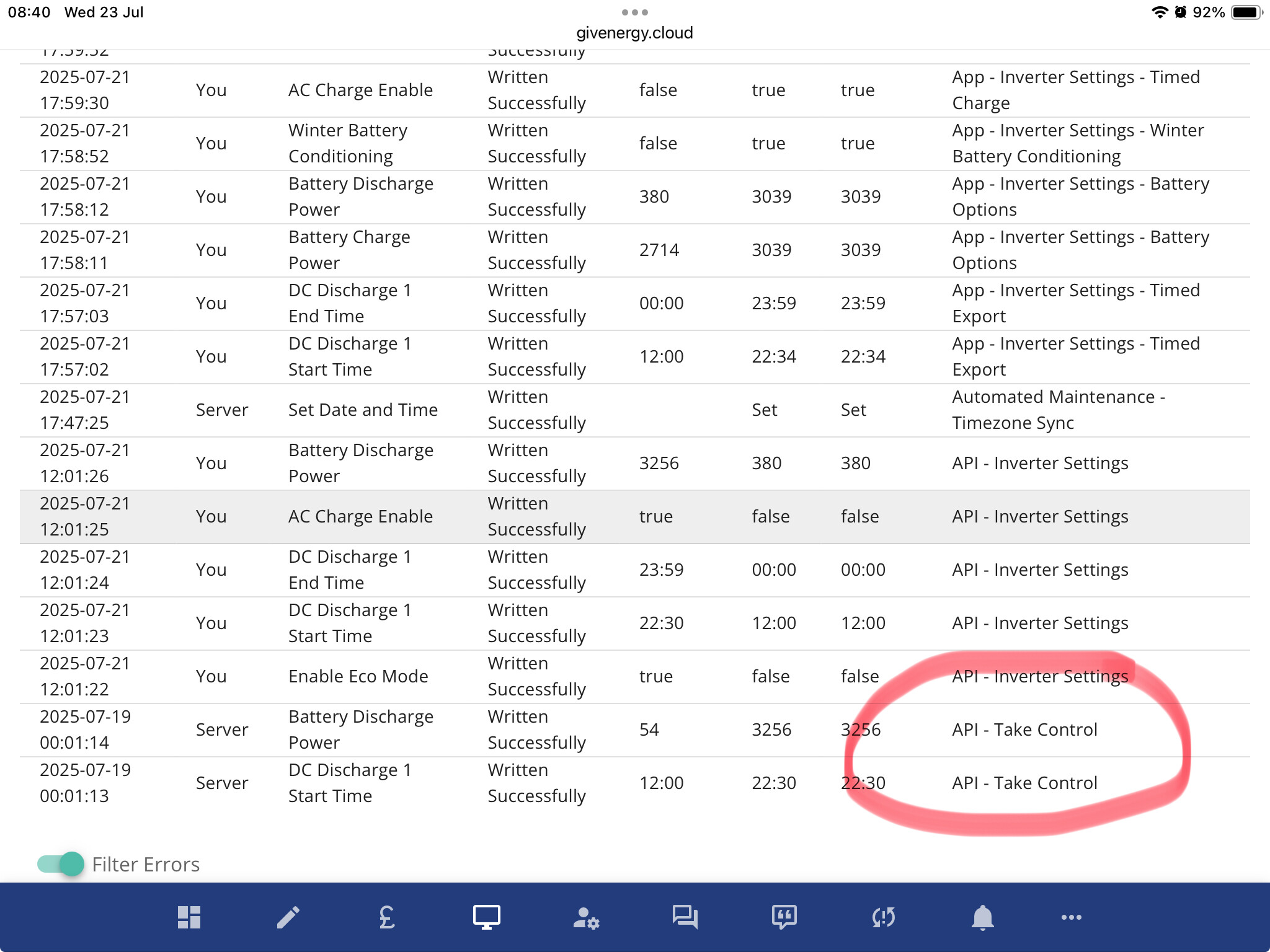

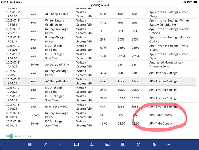

If you go to onto the GivEnergy Cloud Portal, click My Inverter then Remote Control (cog icon). Click the Goto Logs button in the top left corner. You should be able to see in the logs what set the discharge.

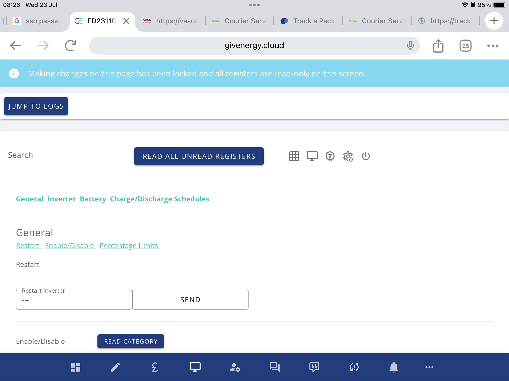

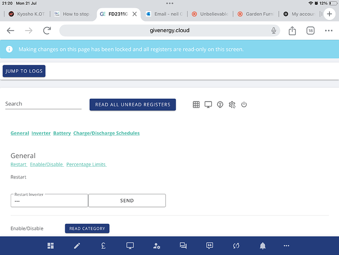

I think s something to with the app, as I can change the settings with the app on my phone but the not on the cloud/portal web site ?
It tells me it’s locked.
You should still be able to jump to, or scroll down to the logs to see which app is controlling / locking your inverter.

Ok I’ve looked and it says API server took control.

Both APP and Cloud are locked
I’m not able to make any changes
