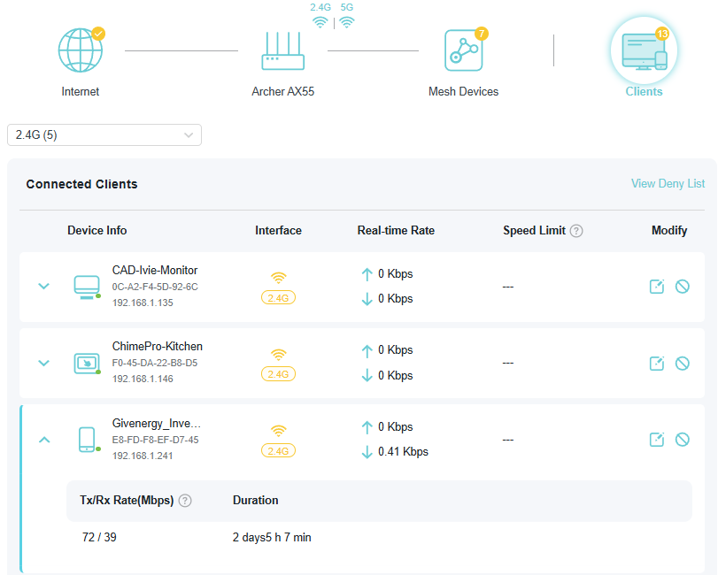

Odd, mine is rock solid:
I have given it a reserved IP:
I’m also on dongle firmware 206 which has better support for 2.4GHz and 5GHz on the same SSID.
I’ve reserved an IP for it so have a feeling the lack of connection might be due to me tinkering a bit too much with the router settings.
Other than reserving an IP did you need to change any other settings? If not, then I might just need to reset the router and hope for the best.
No just reserved IP.
the inverter ONLY connects on the 2.4GHz wifi network, but once it is connected, it is stable

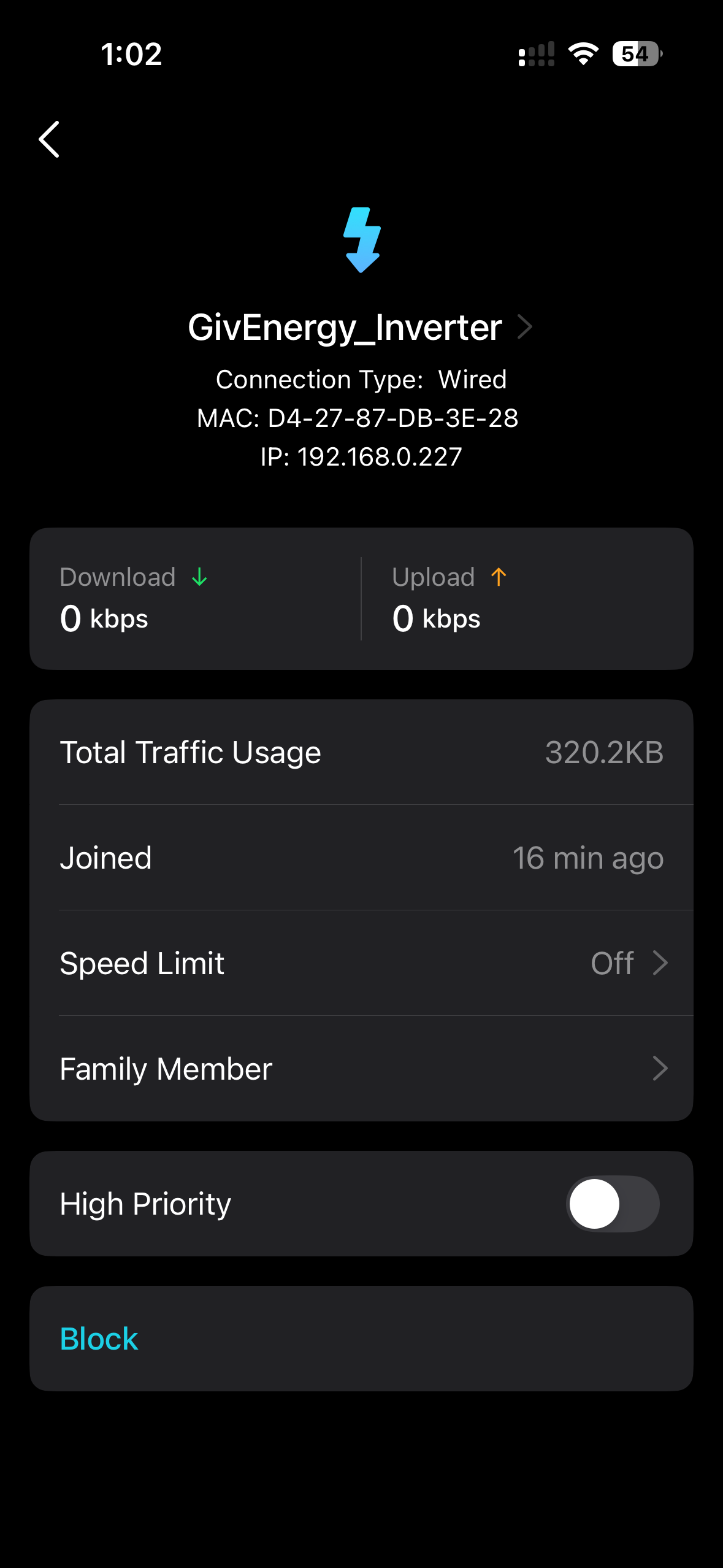

The inverter is connected via Ethernet. It’s located in our garage so connecting via WiFi would require setting up a mesh network to boost the signal to the 60% signal strength required.
I did try resetting the router last night to see if I had accidentally switched a setting which resulted in the router blocking the dongle from communicating with the internet, but unfortunately that didn’t seem to help. I’ve had the IP address allocated to the inverter (mine seems to sit on 192.168.0.227), but again no luck there either.

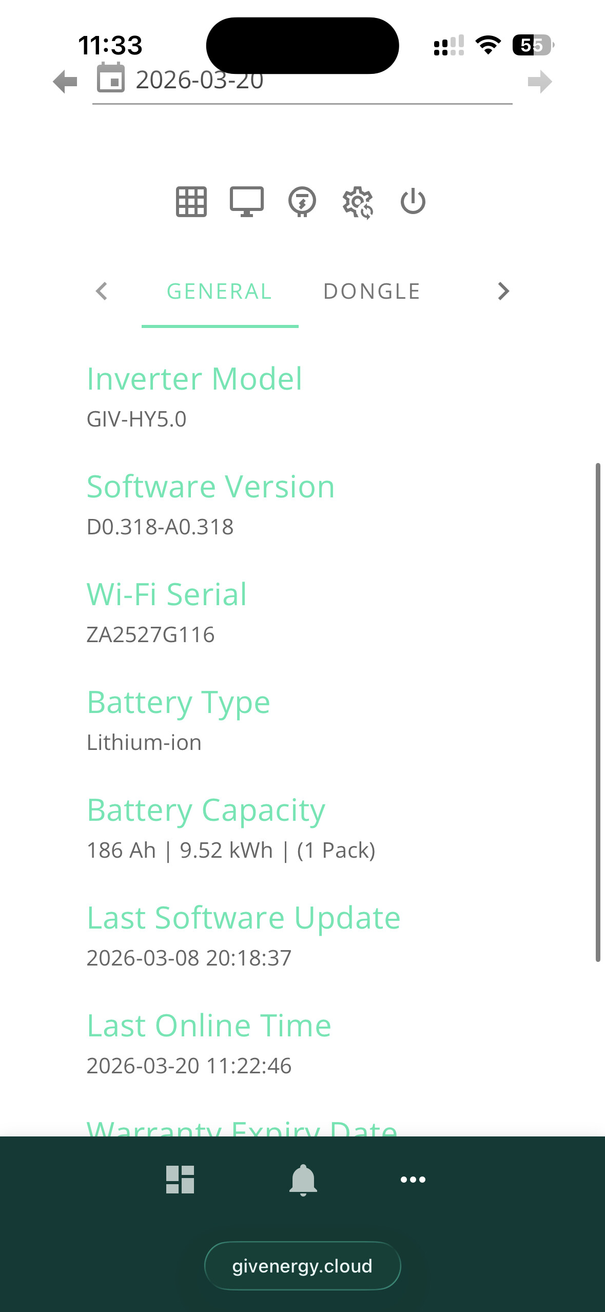

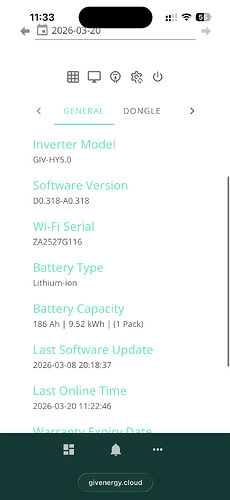

Definitely a gen 3 inverter - not entirely sure what software it’s running but hopefully that photo of the cloud page should help.
Think you’re right about the firmware being the cause as I did manage to get the inverter to connect to the cloud this morning, only for it to disconnect once Predbat sent a charge request via GivTCP.
I’ll take a look at GitHub to see if there’s a fix.
