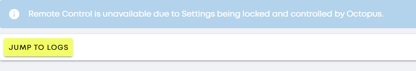

Has anyone identified a way out of this? I have disconnected my inverter from Octopus Intelligent Flux with a view to changing tariff for the winter. However my inverter remains locked. Octopus CS say it may be unlocked in a few days but they didn’t seem to know?
I’m in the same position as you. I changed tariffs over the phone with Octopus last week moving from Intelligent Octopus Flux to standard Octopus Flux. As part of that they removed my GivEnergy “device” from the app and switched my tariffs but still the lock remains. Numerous calls to Octopus and GivEnergy have gotten me nowhere. I’ve revoked the API, still locked, physically switched the entire system off and on again, still locked!
So frustrating!!
I have confirmation from GivEnergy, that if you write to them, telling them you are no longer on the tariff, and wish to unlock the device. They will do it.

Hope it helps. I have switched over to another tariff too, still locked, just giving them a few days to see what happens.

Thanks for the reply DREI. I have emailed them within the last few minutes. Let’s hope that they turn it around quickly, however, I’m not sure if it is just me but I’m not sure how I’d check right now as there seem to be some issues with me accessing my inverter in the Cloud website.
It does look like they had some access issues, but the API still worked as Octopus was able to control it and send instructions.
Seems to be back to being locked:
I believe the mobile app should still allow you to change settings, at least for now.
