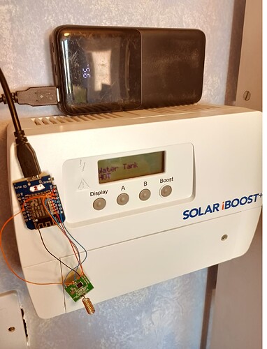

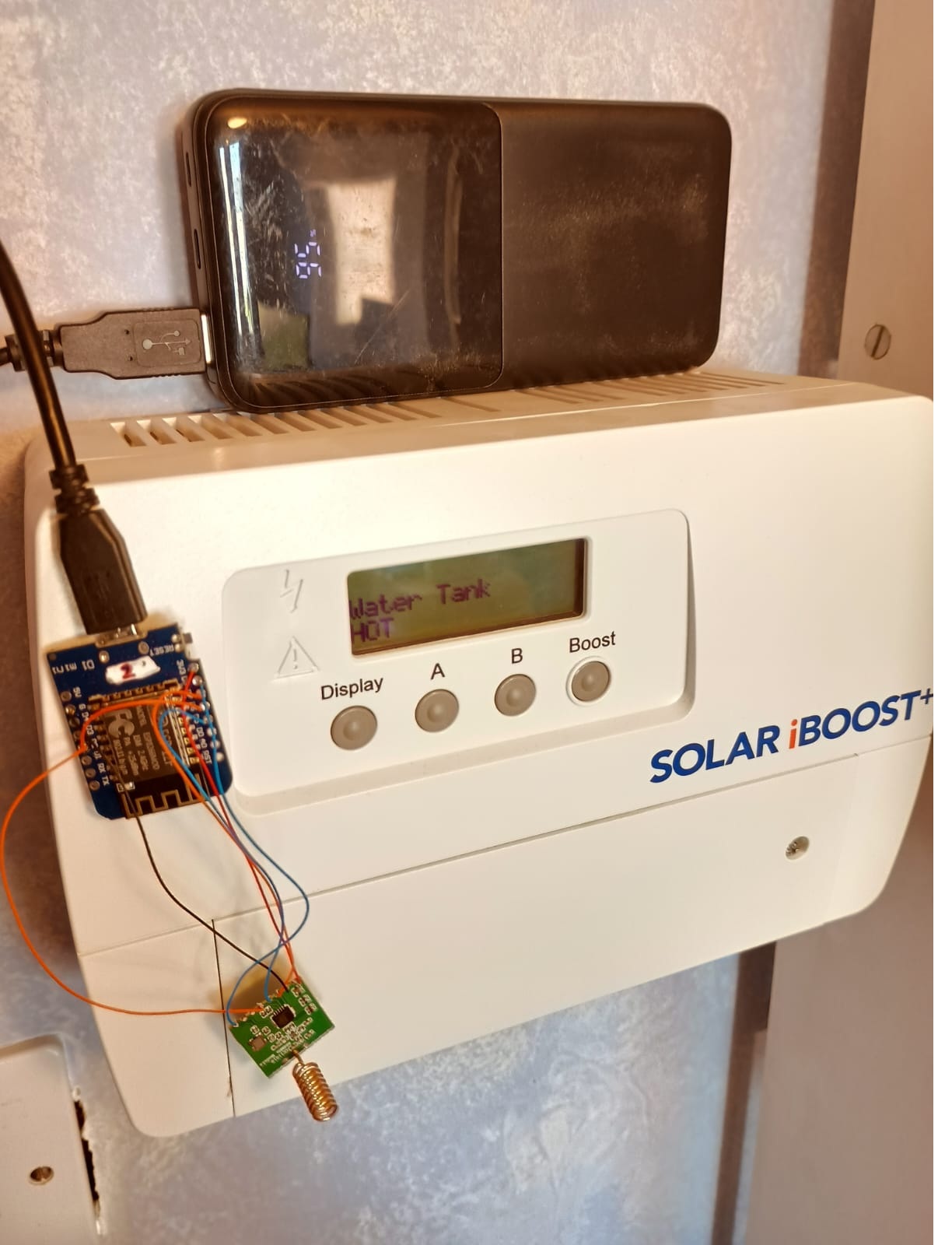

I have been attempting to get this working on my iBoost+, and have built up 2 separate hardware sets. This is all on a fresh install, and I’m still learrning my way into the Home Assistant / ESPHome system. I set up ESP8266 with the wizard (Web - ESPHome), then on-boarded the device to ESPHome and replaced the .yaml file with JNSwanson’s code. I had to edit the code to use an API key rather than password, but other than that it is identical.
Everything looks to work except the 868MHz radio link. The log shows messages "[D][text_sensor:120]: ‘iBoost Warn’ >> ‘’ and the web interface has all data zero with “iboost mode intitializing…” and never updates. I have seen the notes on tuning the radio by editing the source code. Is this something I need to do even at zero range? If I need to edit the source do I have to clone the git directory locally to my PC or can this somehow be done in HA? (all this takes me some way out of my comfort zone). If at zero range the frequency should be “good enough” then does anyone know what the text_sensor:120 refers to? Any suggestions much appreciated. I attach a picture of my hardware setup. Thanks, Ian
